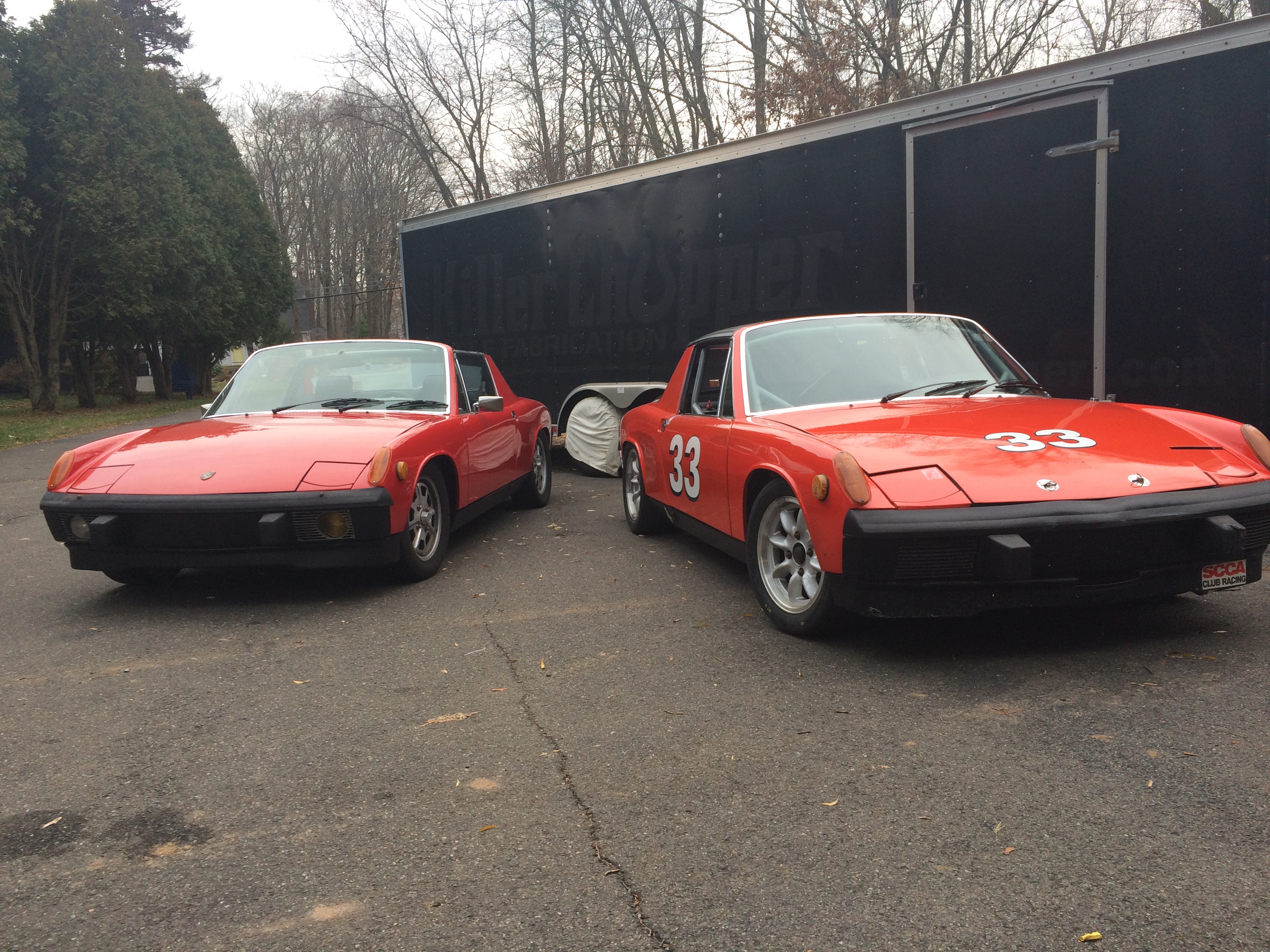

I own and drive both examples: a 2056cc mild-cammed street car that I converted to the Microsquirt, and a 2056cc race-cammed race car that's running on Dellortos. If I were starting with a D-Jet car that I was turning into a race car, or a D-Jet street car that I was going to mod for light sport use, I'd go the Microsquirt route again. Warm-up and driveability is much better than the Dells and it's tunable on-the-fly.
I also noted that my MAP was always around 95% or more, even at full-throttle and high RPM (I'll run this one to 6500). That indicates to me that the D-Jet induction is not really that much of an airflow restriction...maybe with a bigger cam but not with this one.
For a full-up race car with bigger cams and no concerns about driveability, warm-up, throttle transition and such, then dual carbs are fine. But it won't be as nice a car to drive around daily (it'll certainly sound better though).
I had an ITB setup that I was going to test on the car, a pair of downdraft ITBs that mimic'd Webers on Weber manifolds. It would have been an easy transition, I think, to mount them on the car. But in the end I talked myself out of that and shipped the parts to Carlos to slap onto his build, which is a tad more radical than mime. He'll be doing the same general idea with Microsquirt so I'm looking forward to seeing how it works out.
In the end, if you know how to tune carbs and you have the full gamut of jets/tubes/ etc then carbs are easy...but I suggest plugging in a laptop and retuning based on logged AFR/TPS/MAP maps is a lot easier... - GA
