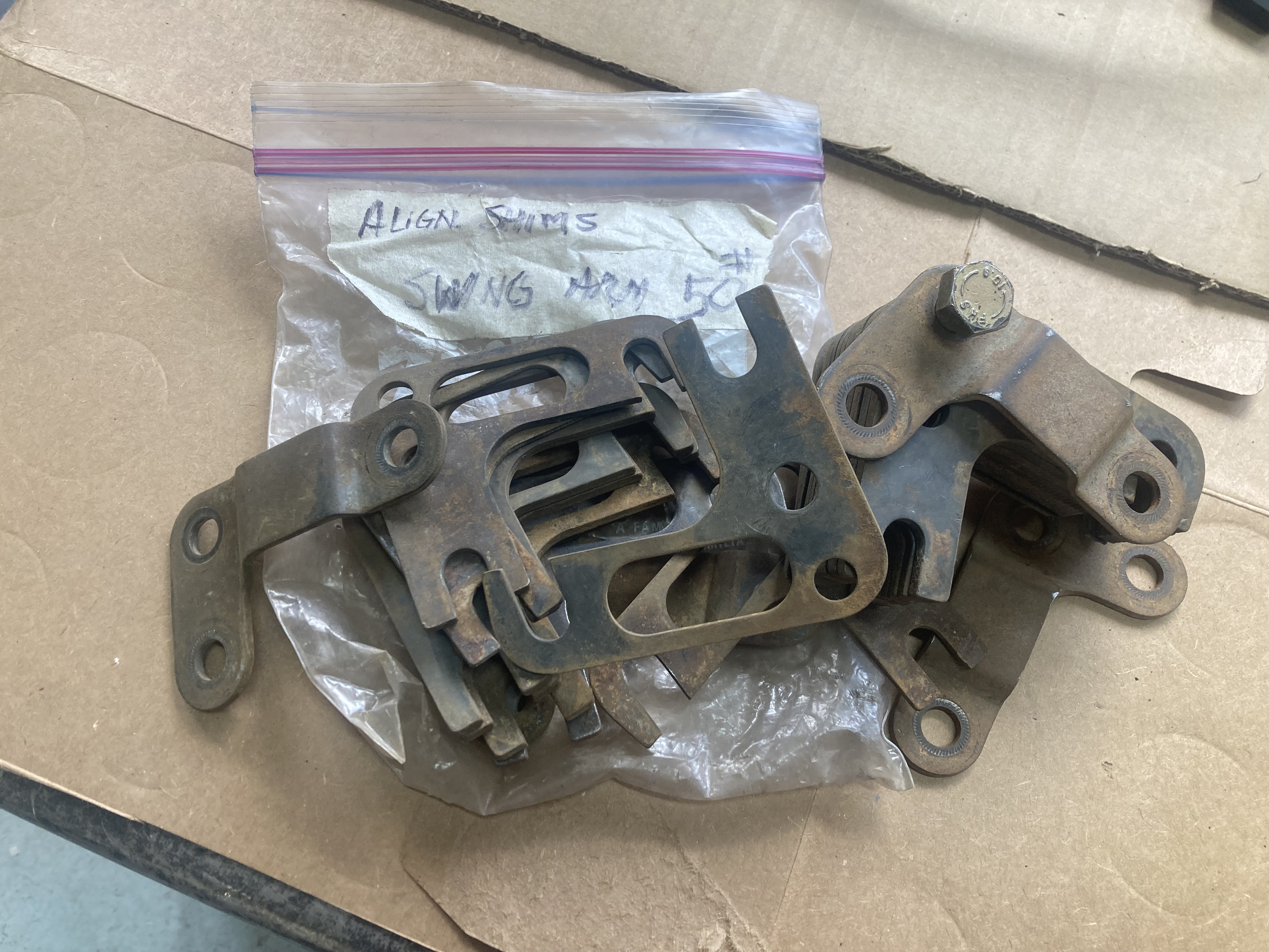

I bought extra shims from this member, I like stainless...
http://www.914world.com/bbs2/index.php?sho...=372781&hl=

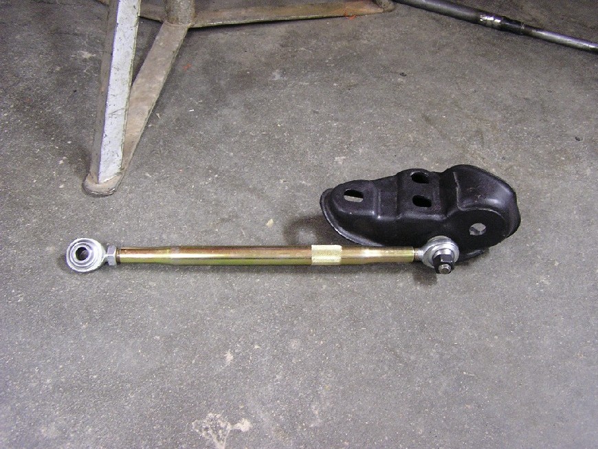

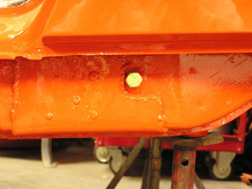

brant
post Mar 29 2025, 09:20 AM
Posts: 12,167
From: Colorado
Member No.: 47
These help keep things the way they should be

Edit: Brant, your shit is BAD-ASSED!
Ninja approved! (IMG:style_emoticons/default/ninja.gif)
If you've got a set up like Brant, you DO NOT need my suggestions...
Brant's set up ALSO provides triangulation on the mount. It's STRONGER!
