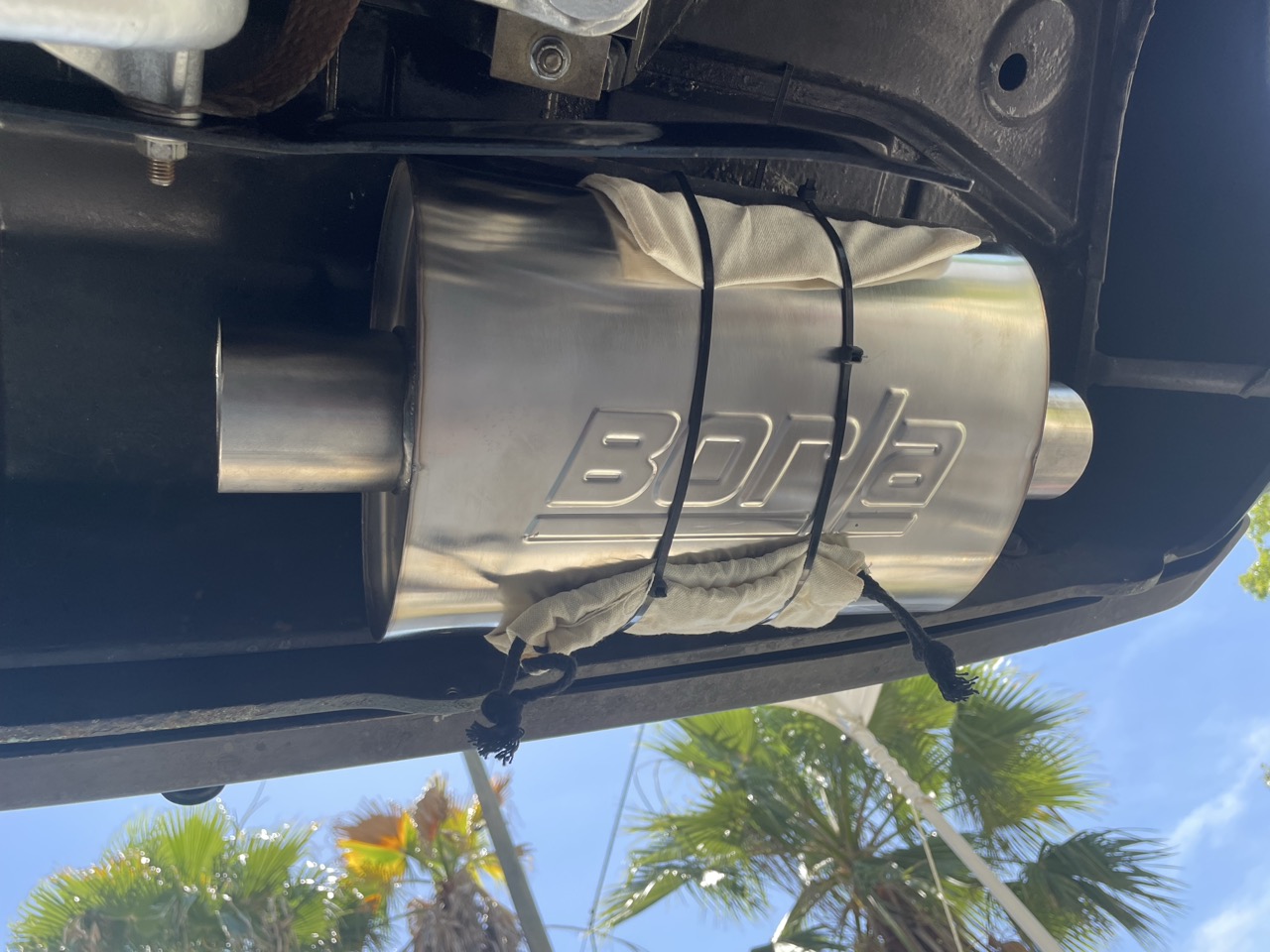

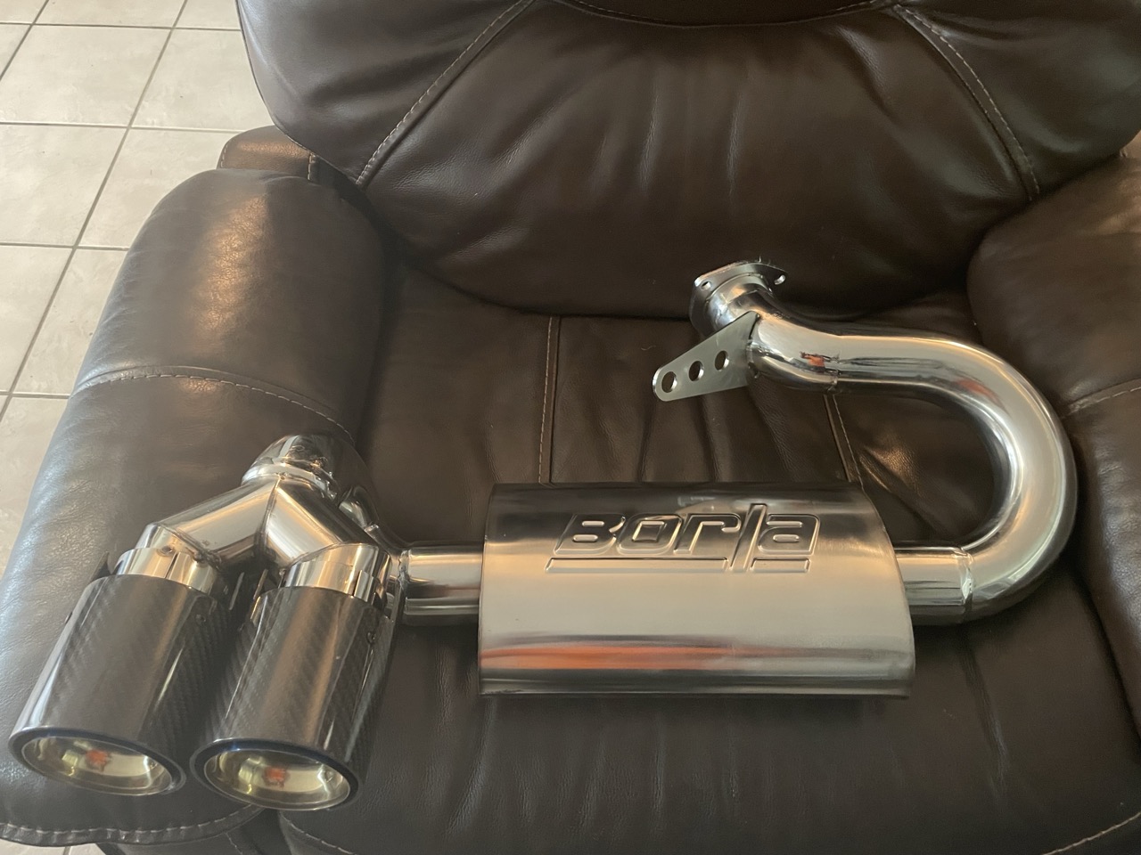

I haven’t heard it start yet so not sure about the sound, but I found a borla exhaust can that fits perfectly up into the exhaust area. You will have to build your exhaust if that is something that is in your wheelhouse. If not shouldn’t be too much for someone to do it for you. It’s a very short run. I ordered everything off of Amazon for around 300bucks. Took one day to build, one day to polish it all out.

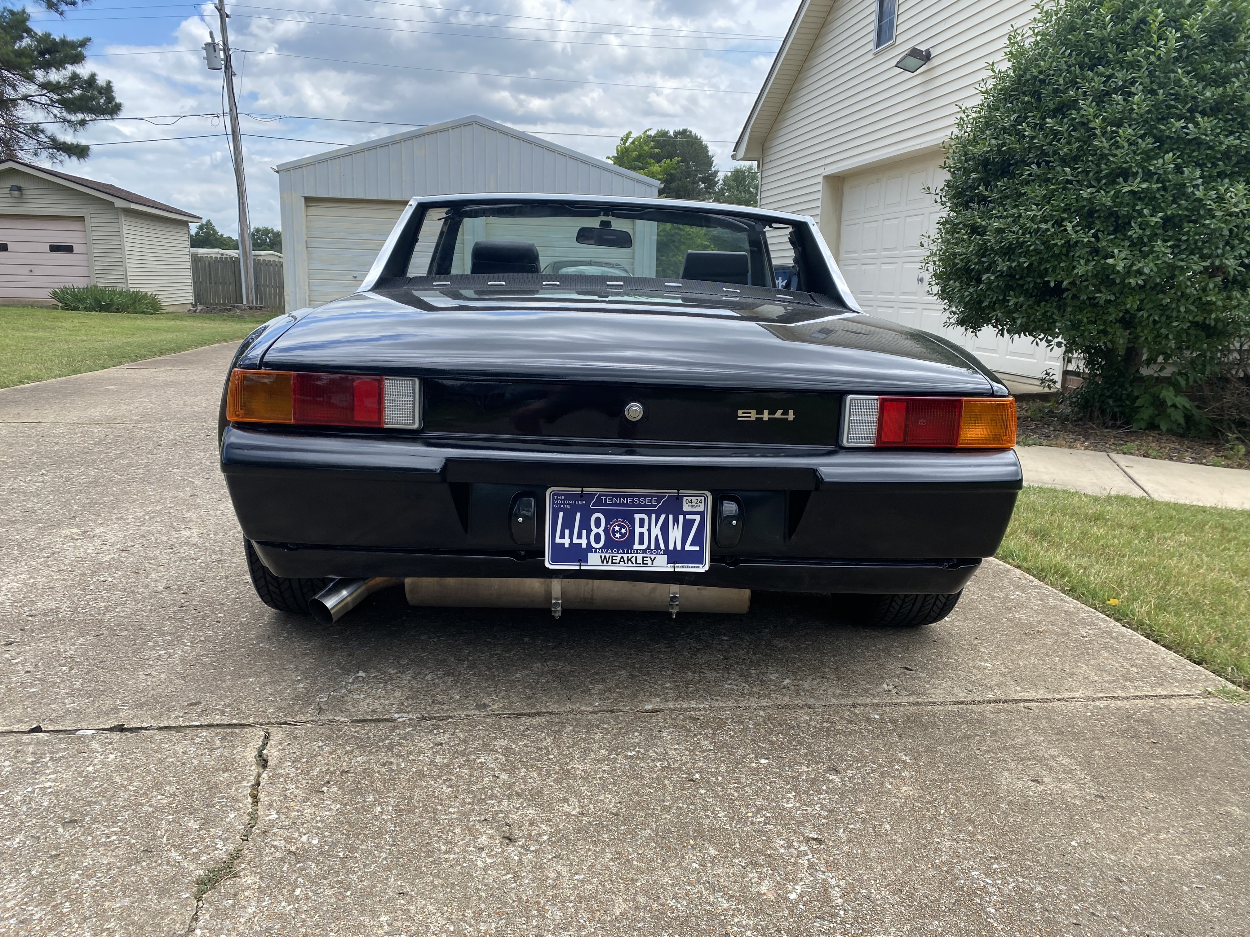

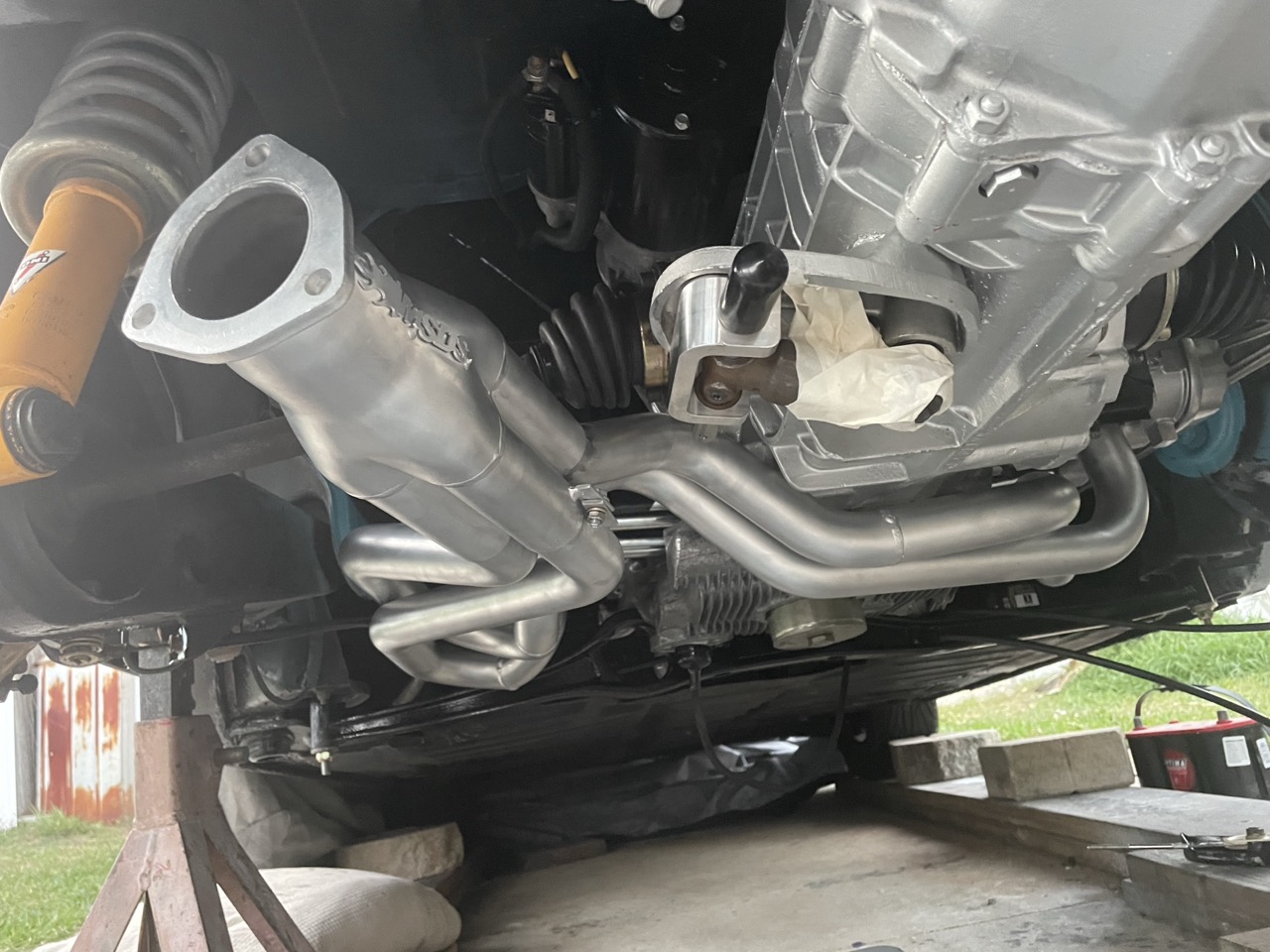

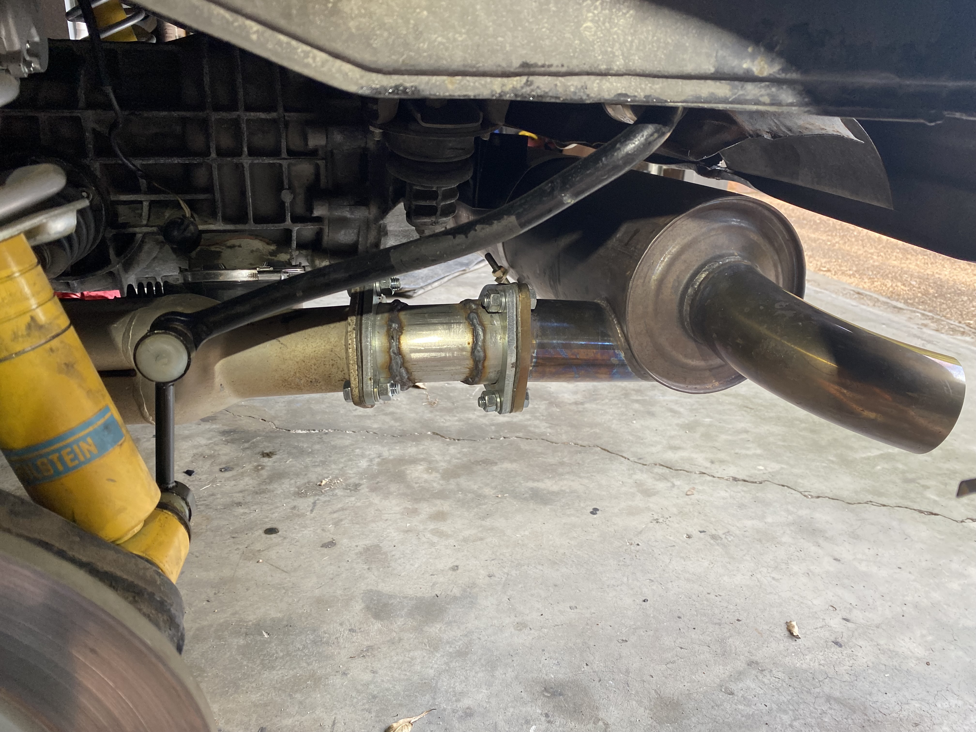

I have a 2270 bid 4 with a MSDS 4 in 1 header. I installed a 1 in 1 out M & K 911 Carrera muffler. It has the same 3 bolt triangle flange. Great sound.

Can you share a pic of your setup and a link to the muffler? Thanks,

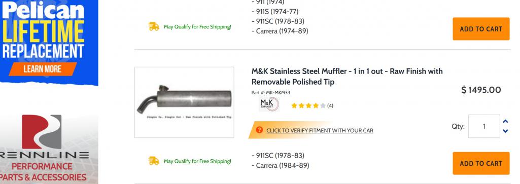

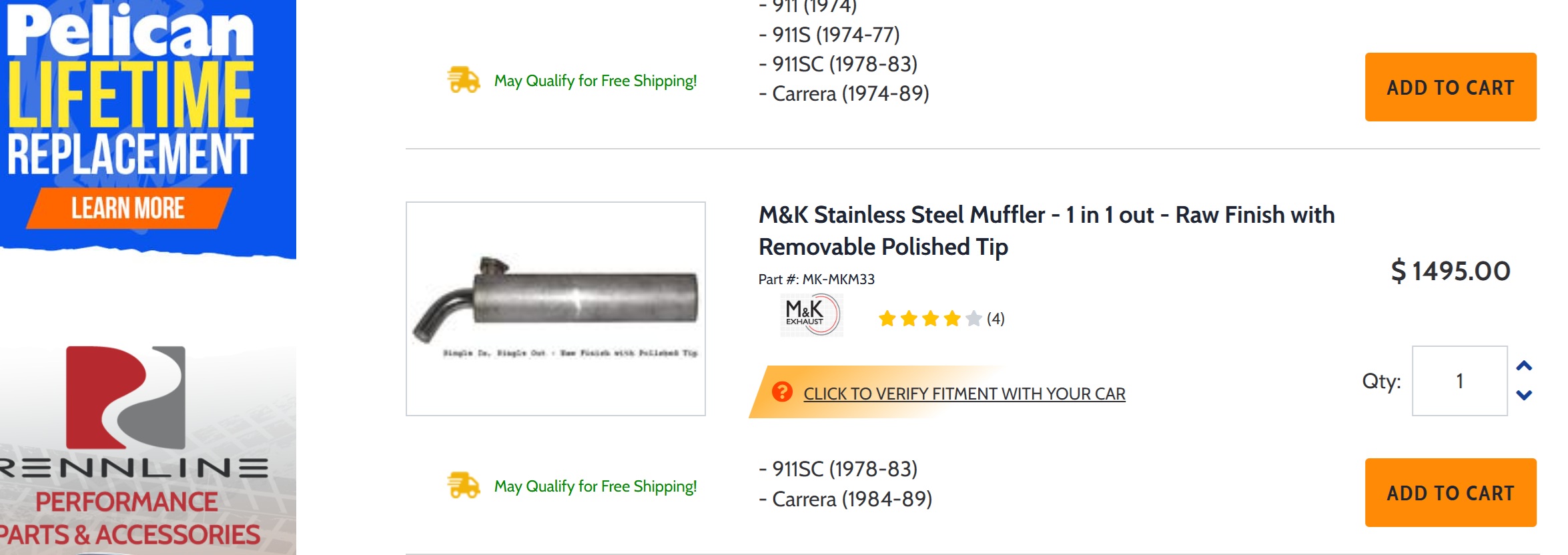

Is this the one? $1500
mm911
post May 29 2025, 12:14 PM
Posts: 27
Joined: 18-January 13
From: martin tennessee
Member No.: 15,385
QUOTE(MedFly914 @ May 29 2025, 12:21 PM) *
Will do
mm911
post May 29 2025, 12:22 PM
Posts: 27
Member No.: 15,385
QUOTE(mm911 @ May 29 2025, 01:14 PM) *
Will do
mm911
post May 29 2025, 12:24 PM
Posts: 27
Member No.: 15,385
QUOTE(mm911 @ May 29 2025, 01:22 PM) *
Will do

I looked at those Tangerine eco systems and they are top notch. I just didn’t want to spend that coin on something I knew I could build myself, and I also wanted something different. I wanted a center mounted exit from under the ground effects. I Put a Borla exhaust on my Jeep last year, and I love the sound that it creates now. Hoping for that same stored energy low tone vibe in the 914.
