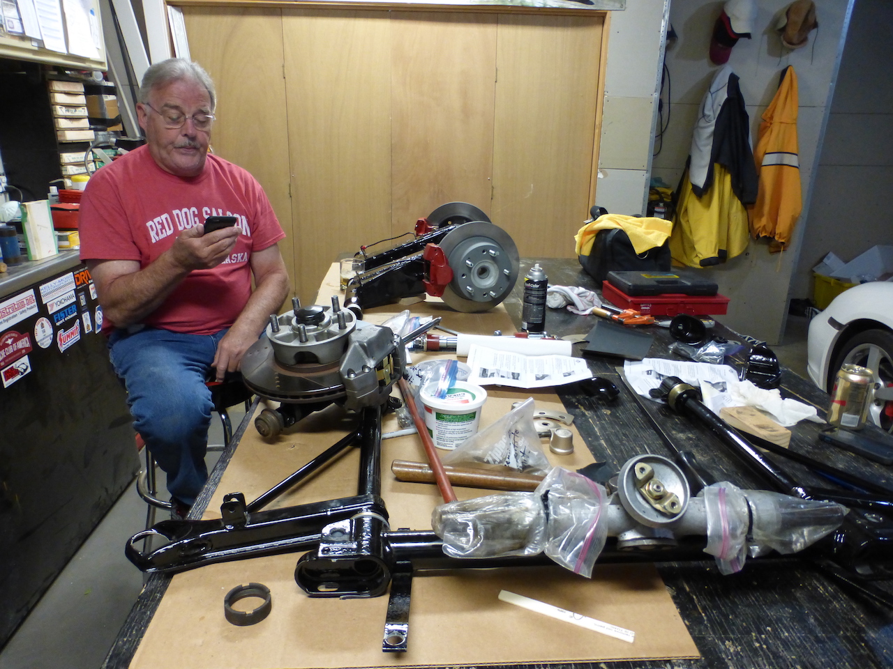

post Sep 22 2025, 07:00 AM
Posts: 1,748
Joined: 11-November 11
From: Merrimac, WI
Member No.: 13,770
Just a fun shot after the install of the Polybronze bushing. All cleaned up, following instructions going in next day. The guy in the picture is my buddy who came to Wisconsin in the middle of winter from Florida to help me and share the fun. MarkAttached Image
