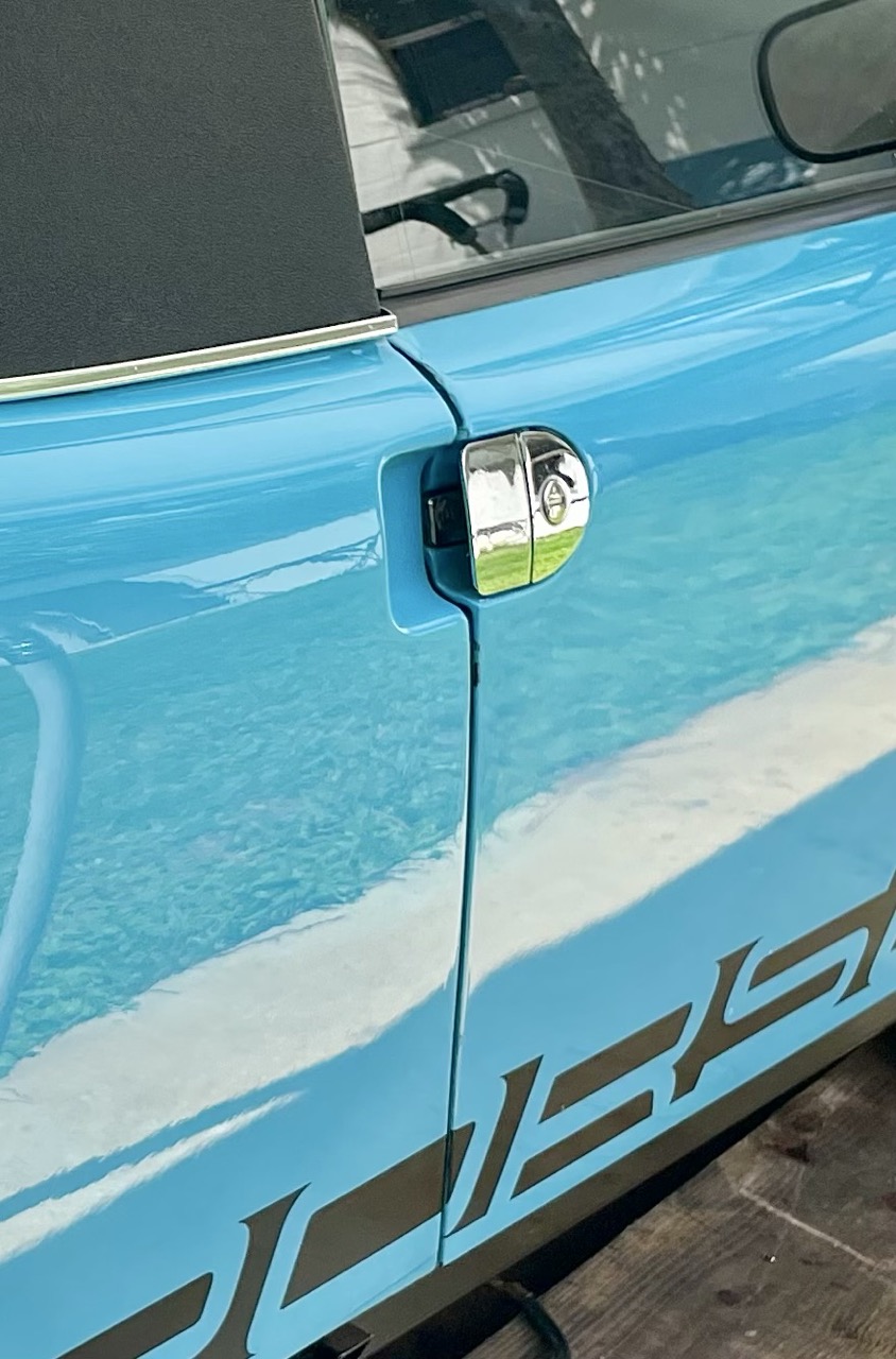

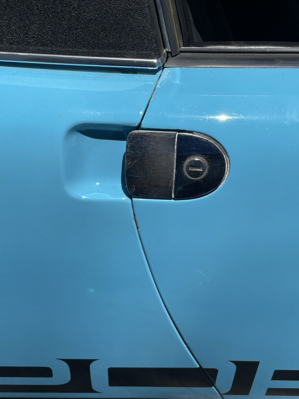

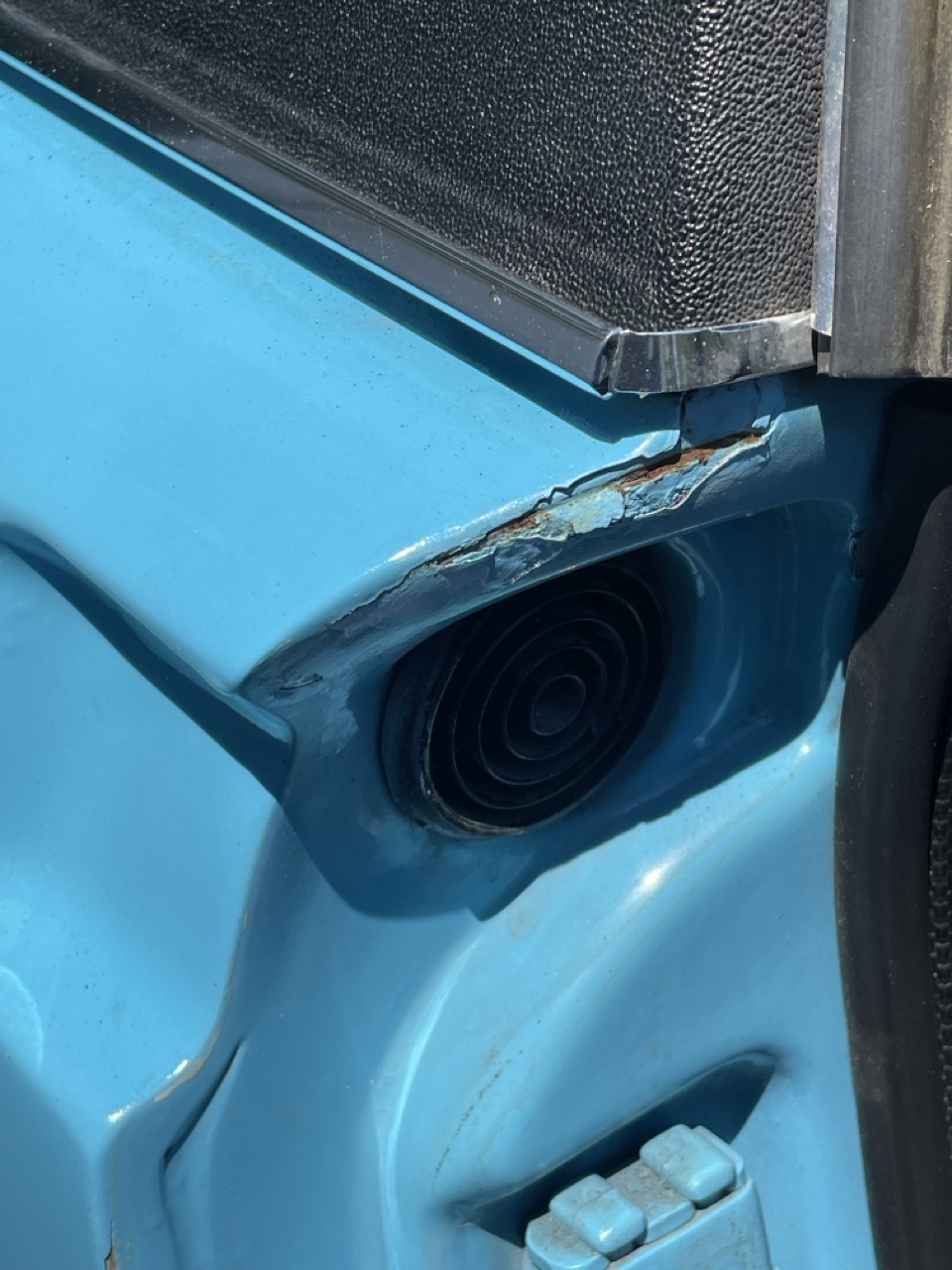

And pay attention to the top of the door at the jam before and after jacking it up, this will clue you to how strong the longs are. If either side changes at all, it’s a no go.
Chad911sc
post Oct 2 2025, 11:34 AM
Posts: 299
Joined: 24-September 24
From: Florida
Member No.: 28,374
When the car got to me from the shipper….
After All the work…..
