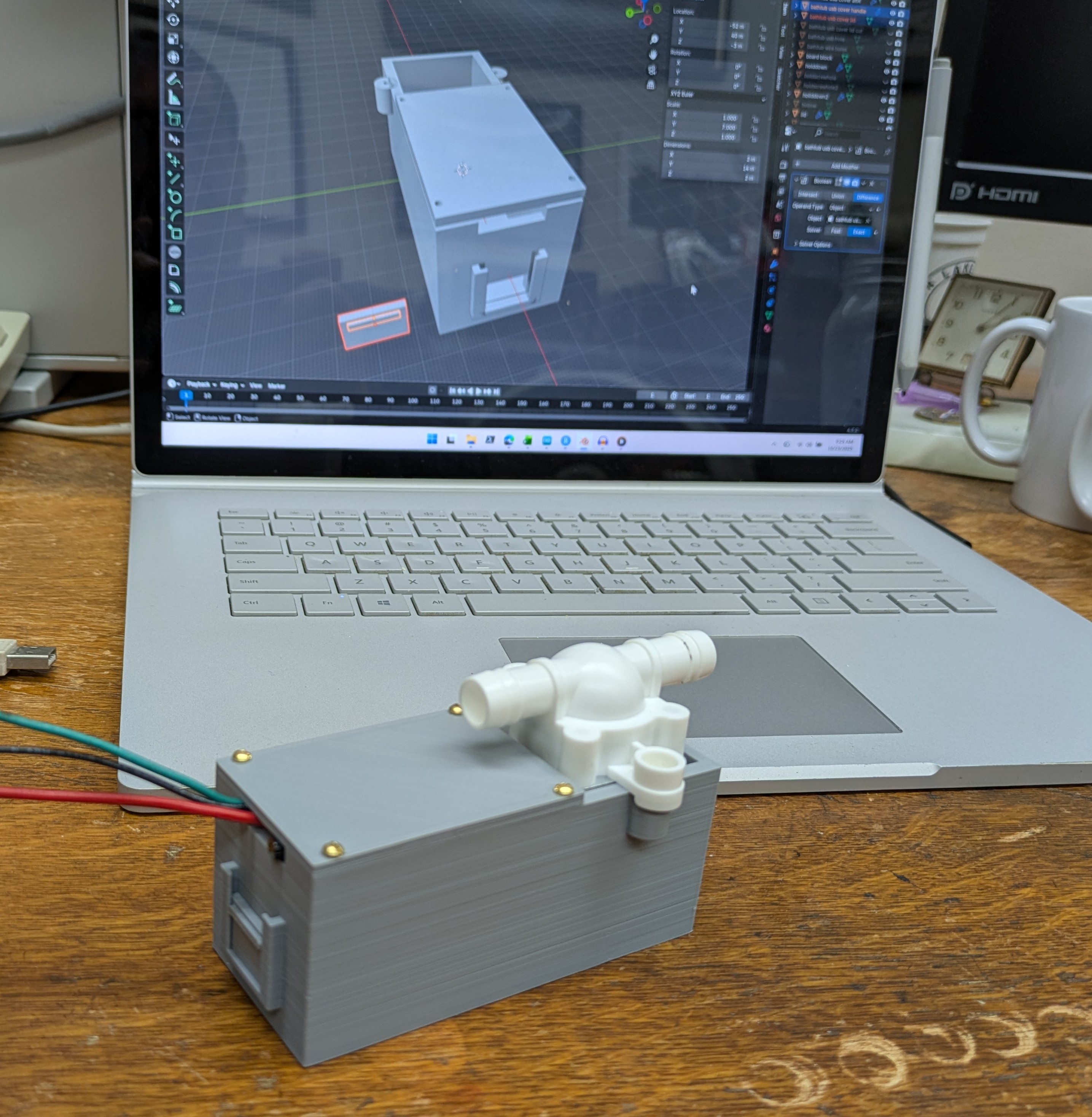

Well, it works on my desk and it works on 12v. Might get around to trying it in the car today.

Progress

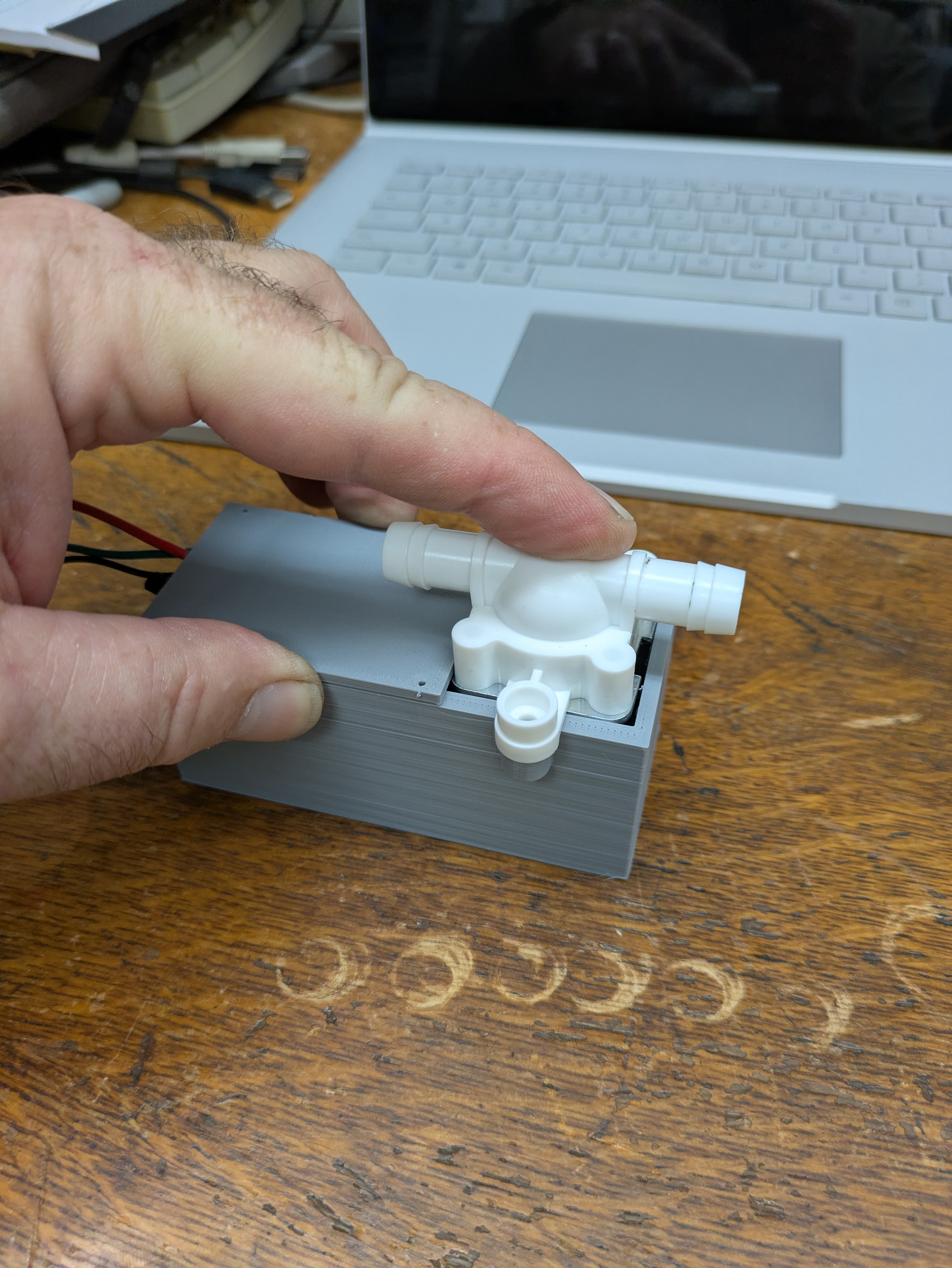

post Oct 23 2025, 07:28 AM
Posts: 3,506
Joined: 20-July 21
From: Upstate, NY
Member No.: 25,740
More progress. Ready for a test run.

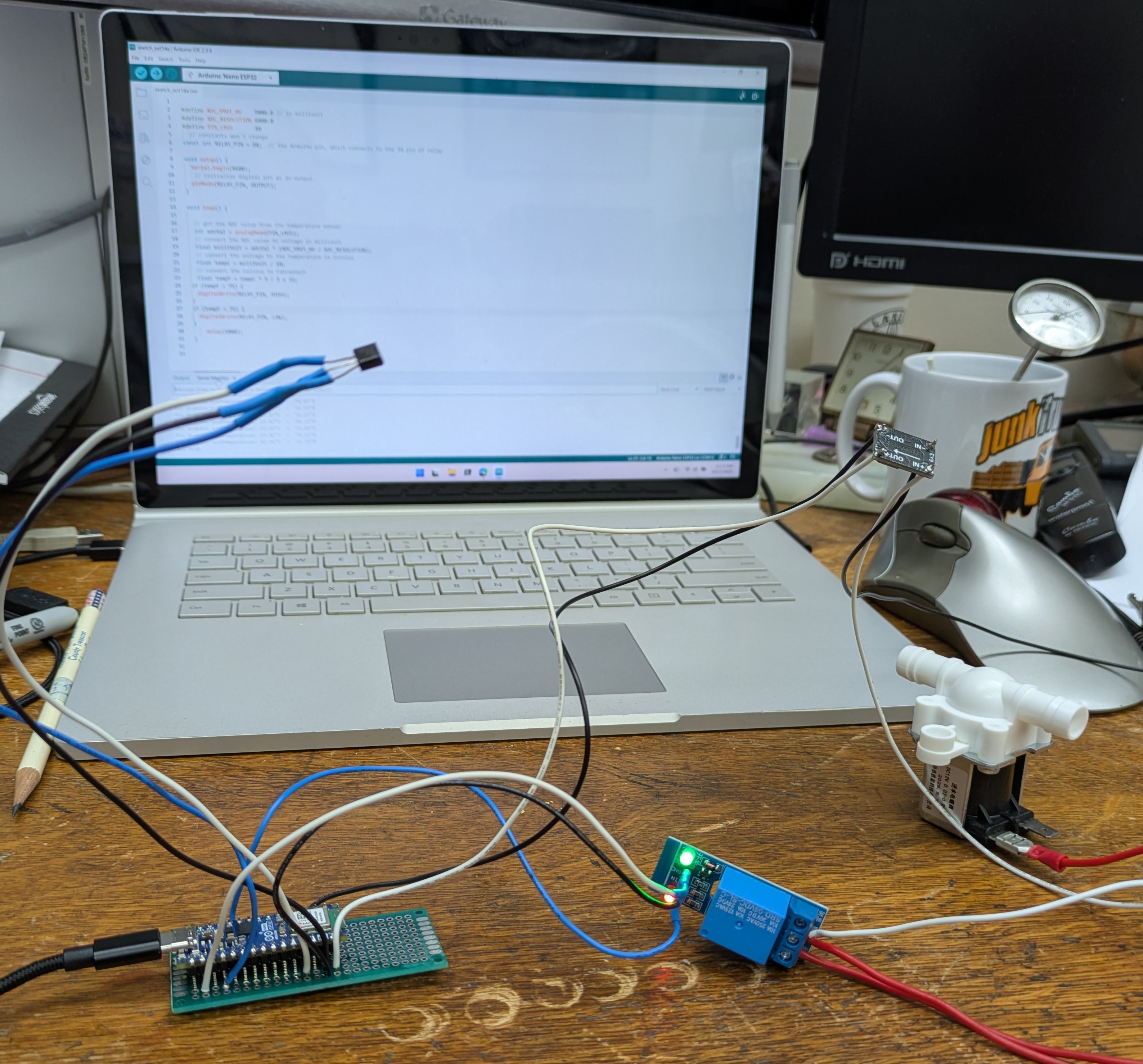

Here are my routines so far. Anybody think of any other things I can try to address with the AAR? The temp sensor is ambient temp, about 3 or 4 inches from the block.
#define ADC_VREF_mV 5000.0 // in millivolt
#define ADC_RESOLUTION 6000.0
#define PIN_LM35 A0
// constants won't change
const int RELAY_PIN = D8; // the Arduino pin, which connects to the IN pin of relay
void setup() {
Serial.begin(9600);
// initialize digital pin as an output.
pinMode(RELAY_PIN, OUTPUT);
// get the ADC value from the temperature sensor
int adcVal = analogRead(PIN_LM35);
// convert the ADC value to voltage in millivolt
float milliVolt = adcVal * (ADC_VREF_mV / ADC_RESOLUTION);
// convert the voltage to the temperature in Celsius
float tempC = milliVolt / 10;
// convert the Celsius to Fahrenheit
float tempF = tempC * 9 / 5 + 32;
//High idle for ~4 seconds on every start up. delay is how long to wait before moving to the next instruction. Delay is in milliseconds
digitalWrite(RELAY_PIN, HIGH);
delay(4000);
//Hot start routine to address low idle when restarting hot
//will probably need to move that temp around to get this right
if (tempF >99){
delay(10000); //hotstart 10 second additional high idle
digitalWrite(RELAY_PIN, LOW);
//Warm start routine
if (tempF <90 and tempF >70){
delay(60000);
//Cool start routine
if (tempF <70 and tempF >50){
delay(120000);
//Cold start routine
if (tempF <50) {
delay(240000);
void loop() {}

So it looks like Arduino is just controlling via high/low binary.
Does the valve have some sort of built-on ramp rate on the open & close? Or, is this just an open / close solenoid valve?

Do you need a default routine that the code falls into after a specific amount to time that closes the valve... in the case where you you don't sense the temp? I'm not familiar with this language so perhaps it's there and I didn't get it.

QUOTE(Superhawk996 @ Oct 23 2025, 09:06 AM) *
yes, it's just telling a relay to trigger. That sends the 12v to the valve, which is just on or off. I am hoping this will be enough. I notice in my car the ramping closed is kind of redundant because the ecu richens the mix enough that after a minute running if I turn off the air flow off it will still idle at 1400.
This is just a run once routine that would only execute the moment you start the car. no loop.
There is an initial 4 sec open routine regardless of the temp.

QUOTE(emerygt350 @ Oct 23 2025, 12:59 PM) *
What the thinking there?
Example - car is hot to very hot. Shut down for let’s say two minutes. At restart it’s going to tend lean just based on temp. Why bleed in more air for 4 seconds when the AAR wouldn’t?
Not being critical - think this is cool that your giving it a whirl and of course if it doesn’t work for whatever reason easy to change code.
There are probably 5 good ways to do this with stepper motors or a solenoid that could be PMW controlled but you’ve actually done something and built something so my hats off to you!!

QUOTE(Superhawk996 @ Oct 23 2025, 11:35 AM) *
That would be the sane thought here, but since this is djet... I think the logic behind the tough start is the heads cool faster than the cylinder and therefore the head temp isn't reflective of the actual temp ending up in a rich condition. I don't know if I believe that or not, considering how heat moves in these engines.
Whatever the underlying cause, when hot in the condition you describe, my car idles low, so I am going to try bring that idle up for 14 seconds (4 seconds because it is a fresh start, and 10 added because the temp sensor sees a hot engine bay). That is the normal amount of time it takes for my car to recover a normal idle in a hot restart situation. I am not sure this will work, or if those are the right times, but it is a start.
The stepper might be where I go next if this doesn't have the resolution needed. I was also looking at a multivalve system. I am afraid that most of the cheap valves of the right size and voltage just don't create a hole big enough for the airflow I need. If I had two valves in parallel, that would give me the ability to roughly alter air available.
We will see. I have a PCA event this weekend so I don't think I will try it on the car till Sunday.
sadly, if they had just added the 6cyl throttle lever to the 4 and dumped the stupid aar, we wouldn't need any of this.

This is probably just a prototype, but I suggest you make the case out of aluminum to stand up to the heat, or Nylon 6-6 which is good to 450 deg F or so.
