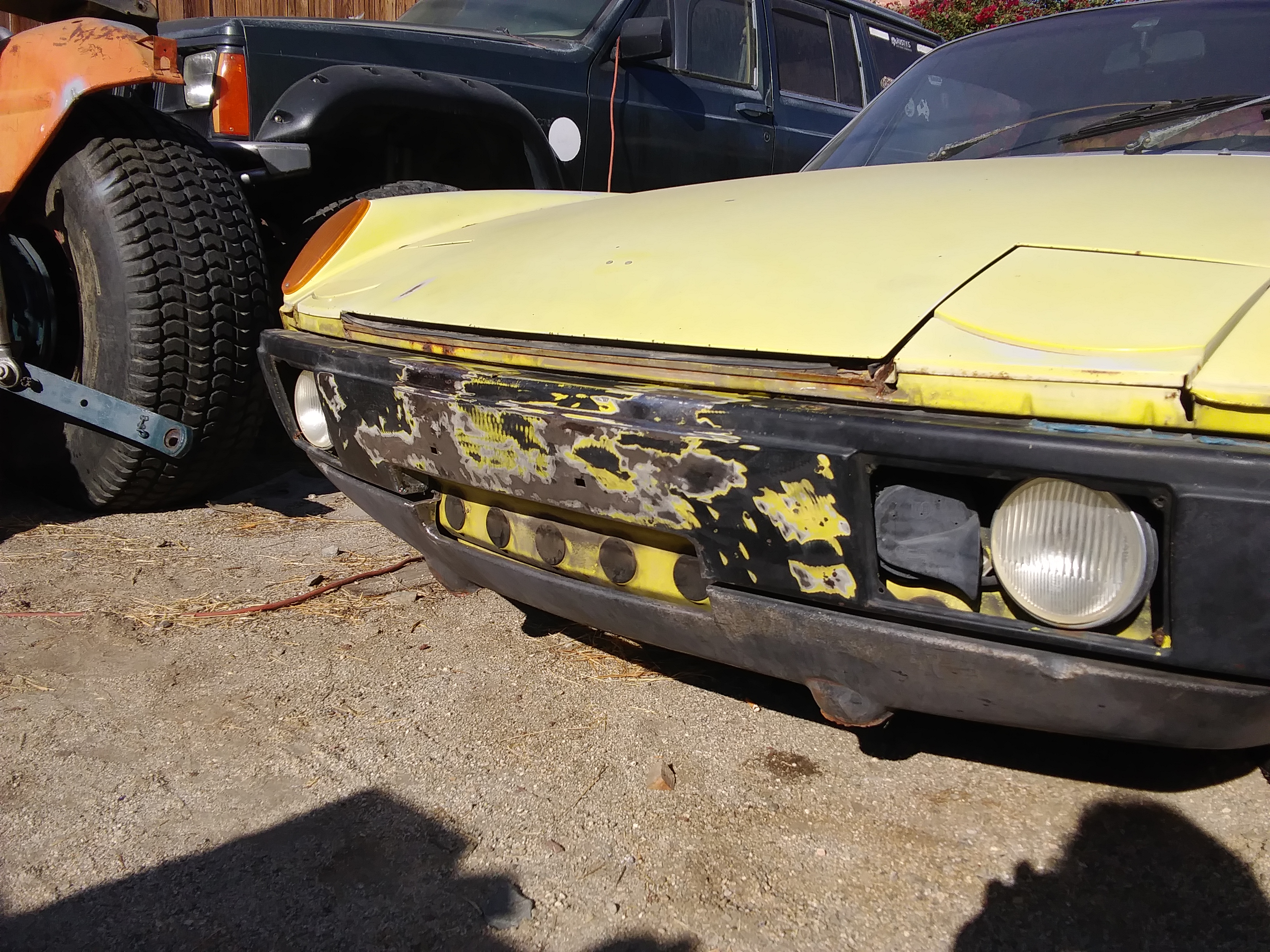

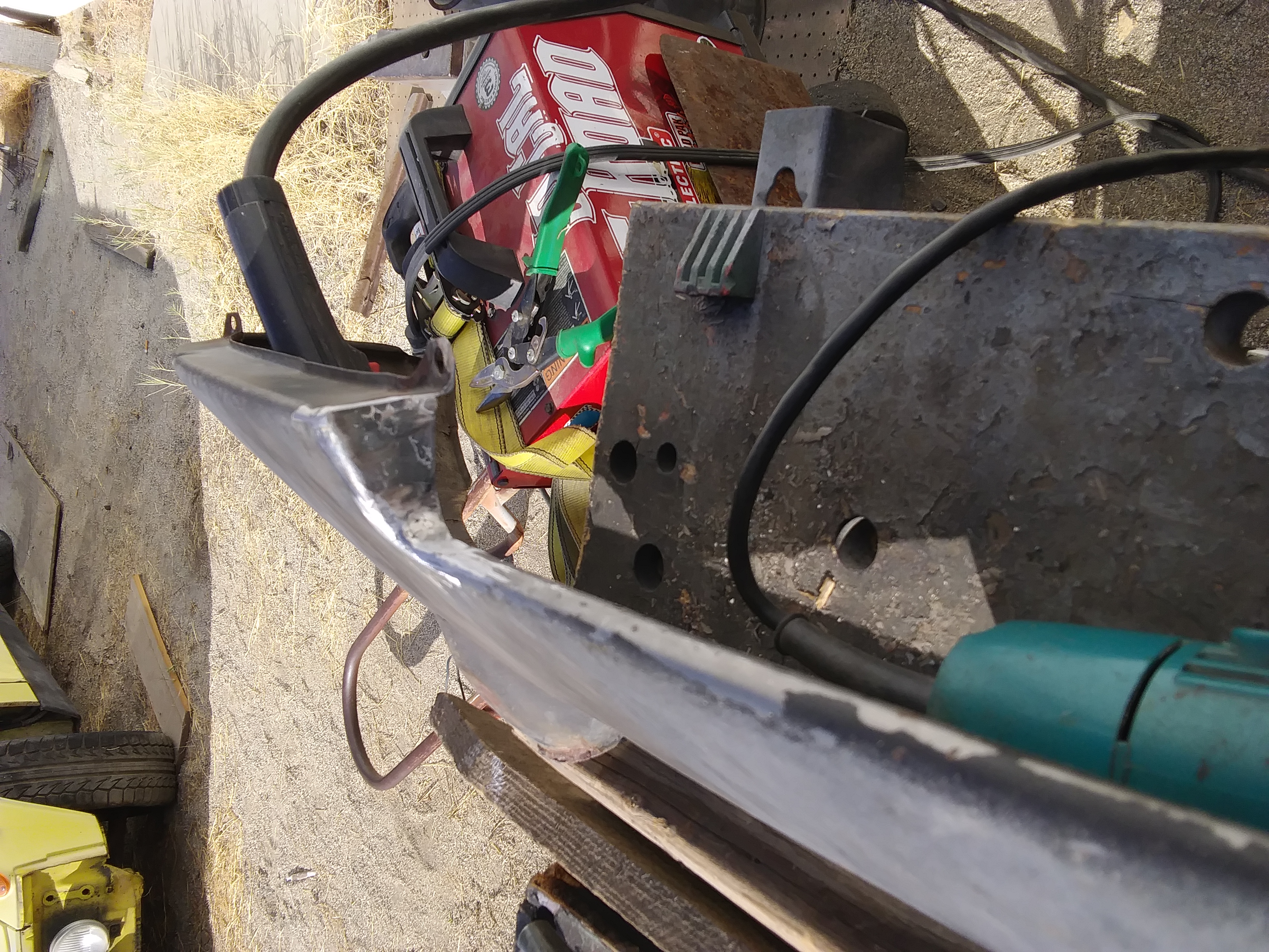

Remember, no. But I went out and measured the bumper opening and that says 19.5"X4.0" total with valance. This caught me off guard so I will mention it. As I drew it on to the valance and bumper I started to notice that the opening is actually curved. Never noticed a frown on any GT's. Well once I was done marking and cutting long, then rolling the metal on the bumper and valance 90 degrees I put it on the car. From the side it frowns but from the front down low it is straight across.

The correct opening is 19-3/4” with 1/2” radius. I have done hundred of bumpers and have a fixture and am always surprised by the DIY on this. It took a while to get good at it.
I reluctantly just did a lower valance for a client /member here but the hours involved are insane and even for what I charge it’s not a break even.

It was a nightmare at times. If I could afford to have you do it I would have. Yes the thin metal of the valance tested my welding…And my patience. But at the time with my wife not well it was a distraction I needed.
