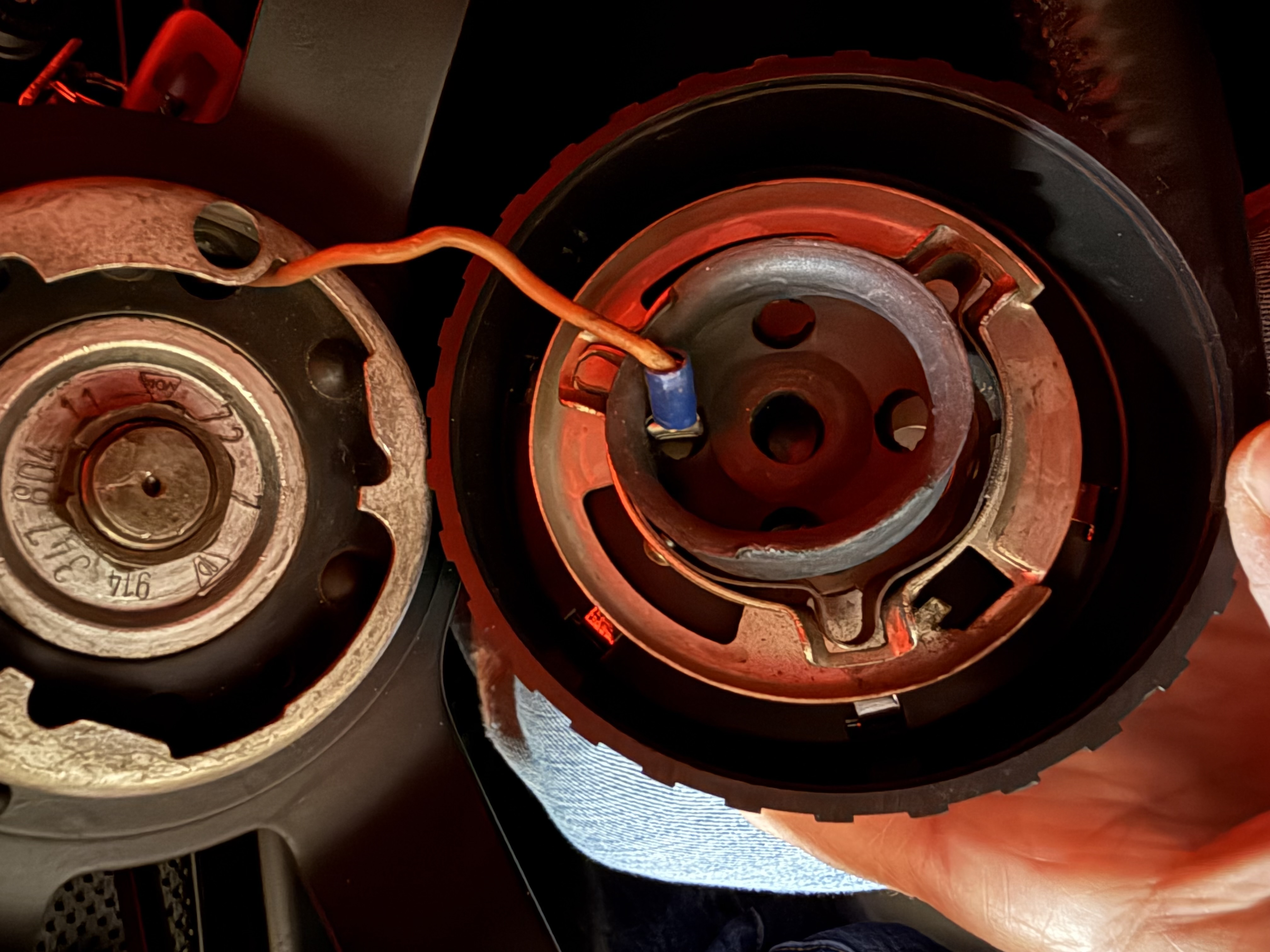

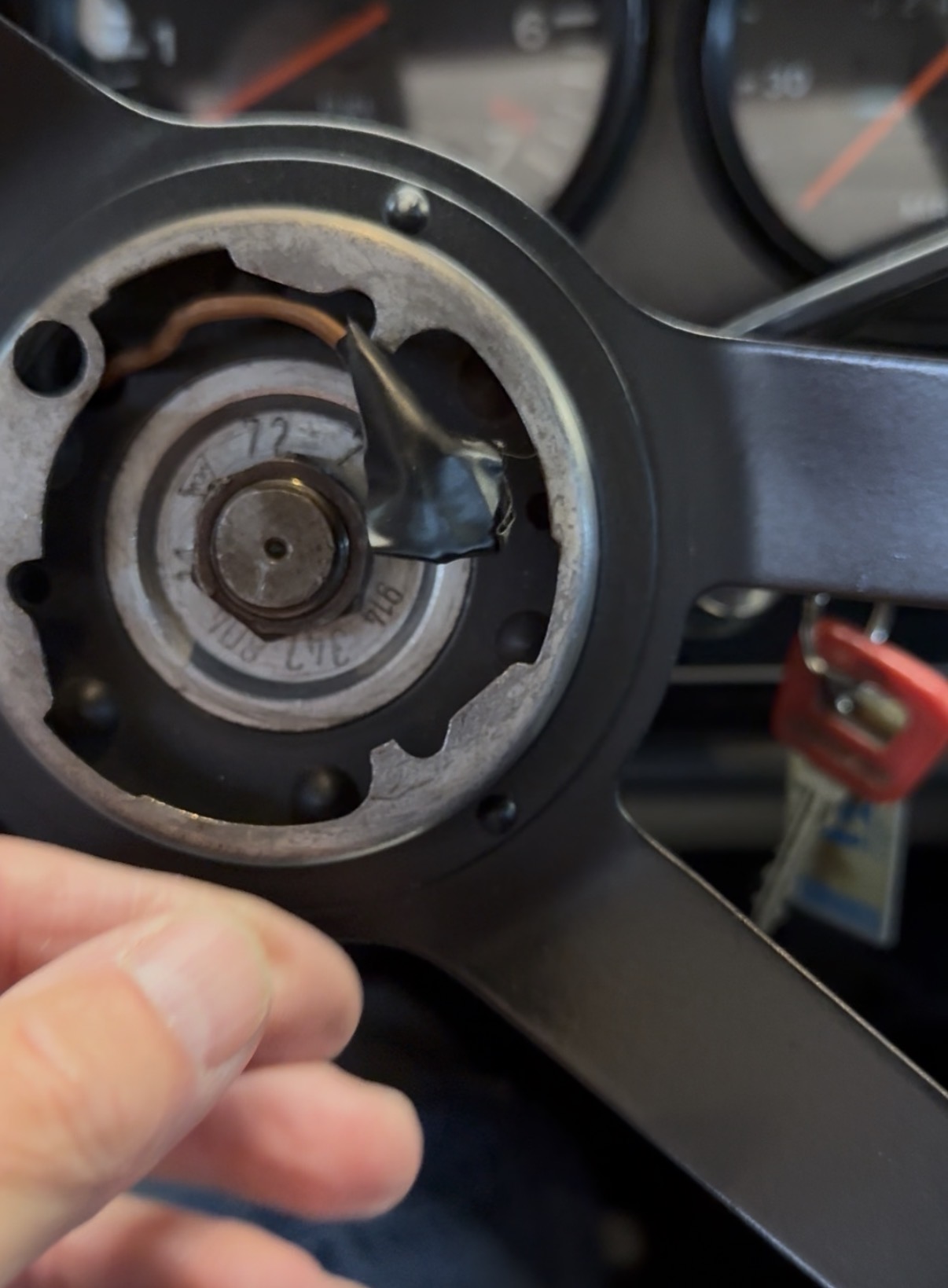

So the horn on my new ( to me) 914 doesn’t work. Pulled the 911 horn pad off just now and as you can see, the brown wire is taped off. Wondering why. But at least I know why we have no sound. Where’s it supposed to attach?

Should be a tab on the back of the horn button.

Yep… found it. Now I know why it was taped up… horn works fine… ALL THE TIME!!! It’s hot. Hopefully just the relay?

You’re grounding the circuit when that wire makes contact with the wheel, when depressing the horn pad. There should be a male tab on the back of the horn pad, to connect the wire to. Many of the tabs are broken off.

the lead does NOT go through the hole in the steering wheel!!

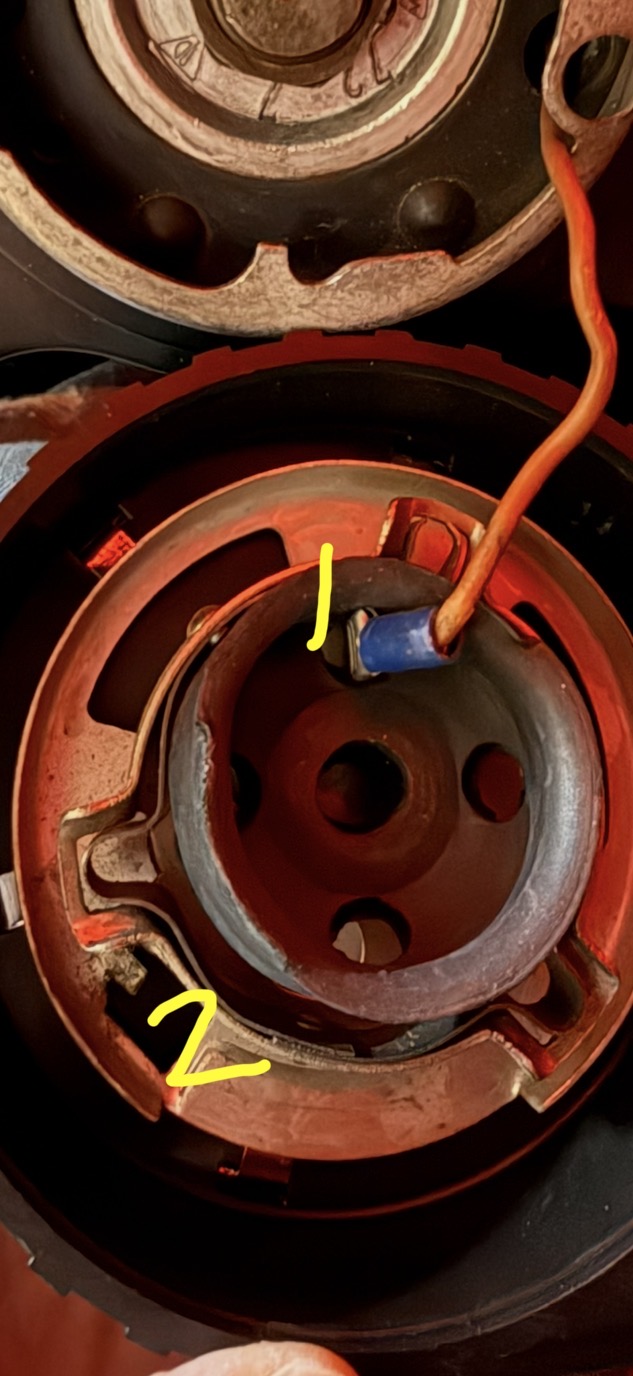

Would moving the wire from position number one to position number two make a difference?

Position 2 is the factory location. The tab that connects to the female connector is broken. I've never seen the horn wire in position one. Position 2 grounds when the button/horn pad is depressed. I think where it is currently it is always grounding causing your horn to sound all the time.

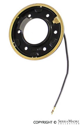

Is the rotating/sliding contact plate still there? That’s where the wire is attached, inside the boss, it may have broken off. It might be possible to repair it yourself by attaching a new wire, or just buy a new assembly from one of the usual suppliers.
Like this one:
https://sierramadrecollection.com/products/...vtuLbMFK_M8pyWa
