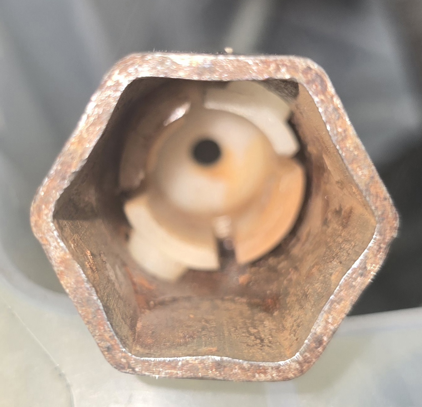

fixer34
post Nov 19 2025, 05:54 PM
Posts: 1,405
Joined: 16-September 14
From: Chicago area
Member No.: 17,908
This plug socket came with my -6 when I got it 48 yrs ago. Plenty long enough and flexible rubber 'cone' inside. Haven't done plugs in years, but if I recall, it worked fine for both insert and remove. Attached Image

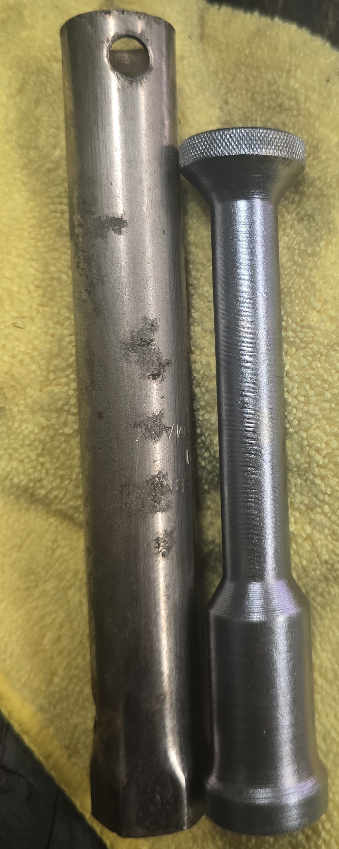

bdstone914
post Nov 20 2025, 07:56 PM
bdstone914
Posts: 5,280
Joined: 8-November 03
From: Riverside CA
Member No.: 1,319
This is a BMW spark plug tool next to a 911 sparl plug tool.
It should work. It uses a plastic clip inside
@sixaddict

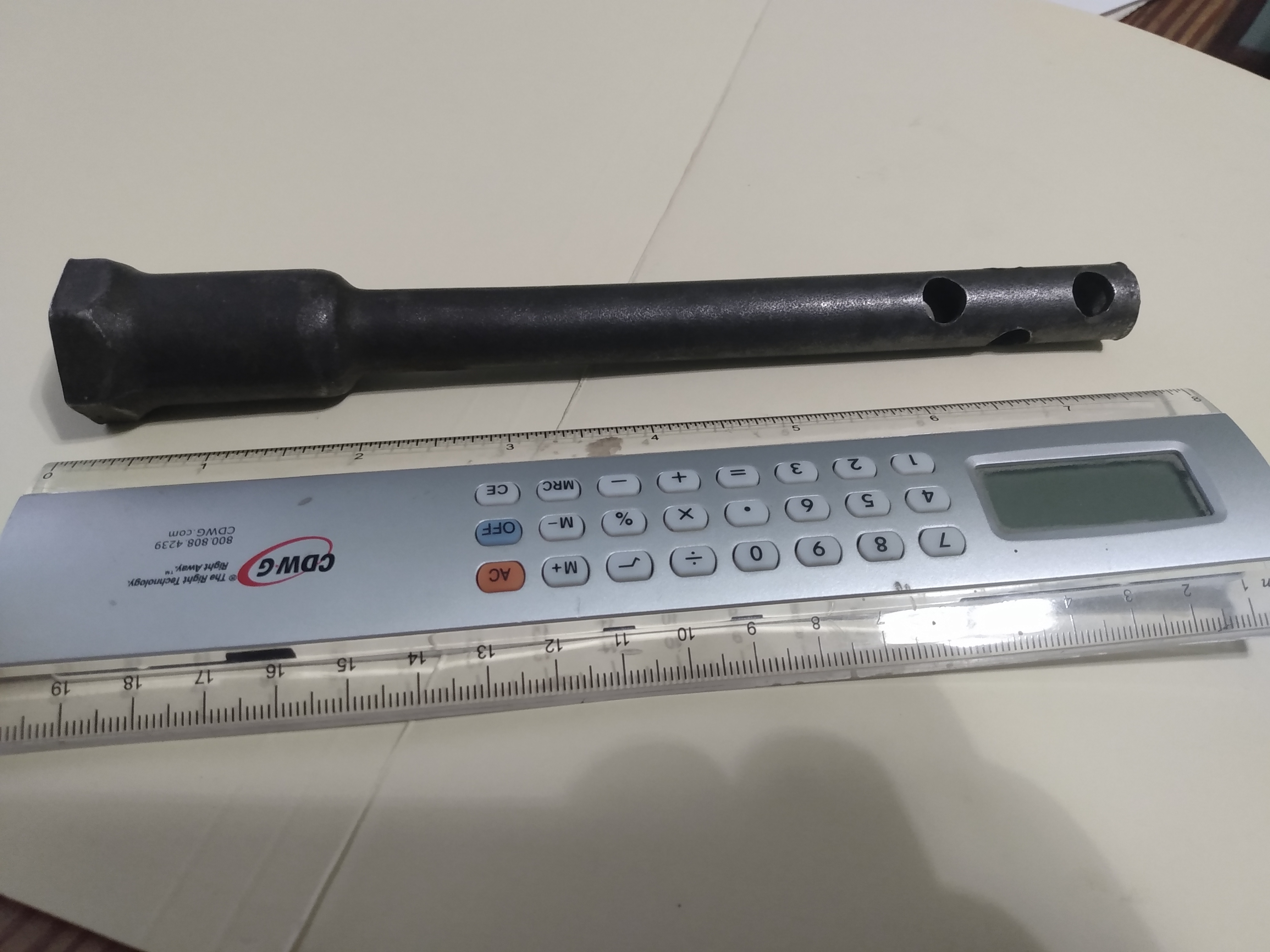

Front yard mechanic
post Nov 20 2025, 10:27 PM
Posts: 1,439
Joined: 23-July 15
From: New Mexico
Member No.: 18,984
QUOTE(bdstone914 @ Nov 20 2025, 05:51 PM) *
QUOTE(rgalla9146 @ Nov 19 2025, 11:13 PM) *
QUOTE(Front yard mechanic @ Nov 18 2025, 07:59 PM) *
Electrical tape is your friend works great for lug nuts too
I agree.
Remove the rubber and put a couple rounds of tape on it and reinstall.
Walla !
Tight as a rats ass.
How do you know that a rats ass is tight?
You could put your finger in itAttached Image
