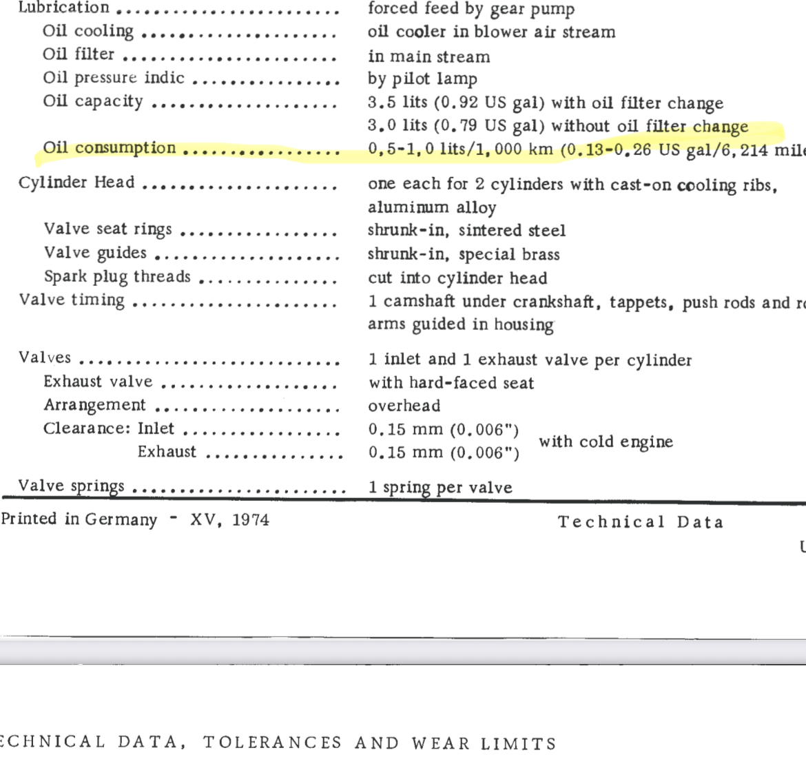

@Superhawk996
ever noticed the typo/misprint in oil consumption amount in that spec posted.
says per 1,000km for the litres. and per 6,210 miles for the us gallons.
they have the litre amount correctly transposed to US gallons.
but they have left a zero off the km conversion.
should be per 10,000km? a km is 0.621 of a mile.

1000 km =621.371 miles . . . So, decimal in wrong position . . . . 1 liter is 0.26 US gallons (approx 1 quart). . . Monday after a 3 beer lunch? (IMG:style_emoticons/default/confused24.gif)
Hopefully OP has a little more background and/or has access to a leak down gauge.
Note: 1L of oil consumption per 10,000 km isn’t plausible for an air cooled engine design with origins that date back to the 30s.

That is a very typical consumption number for vintage engines from 60s and 70s. It was a well known rule of thumb when I was a kid. Check oil level at every fill up used to be a common recommendation.
