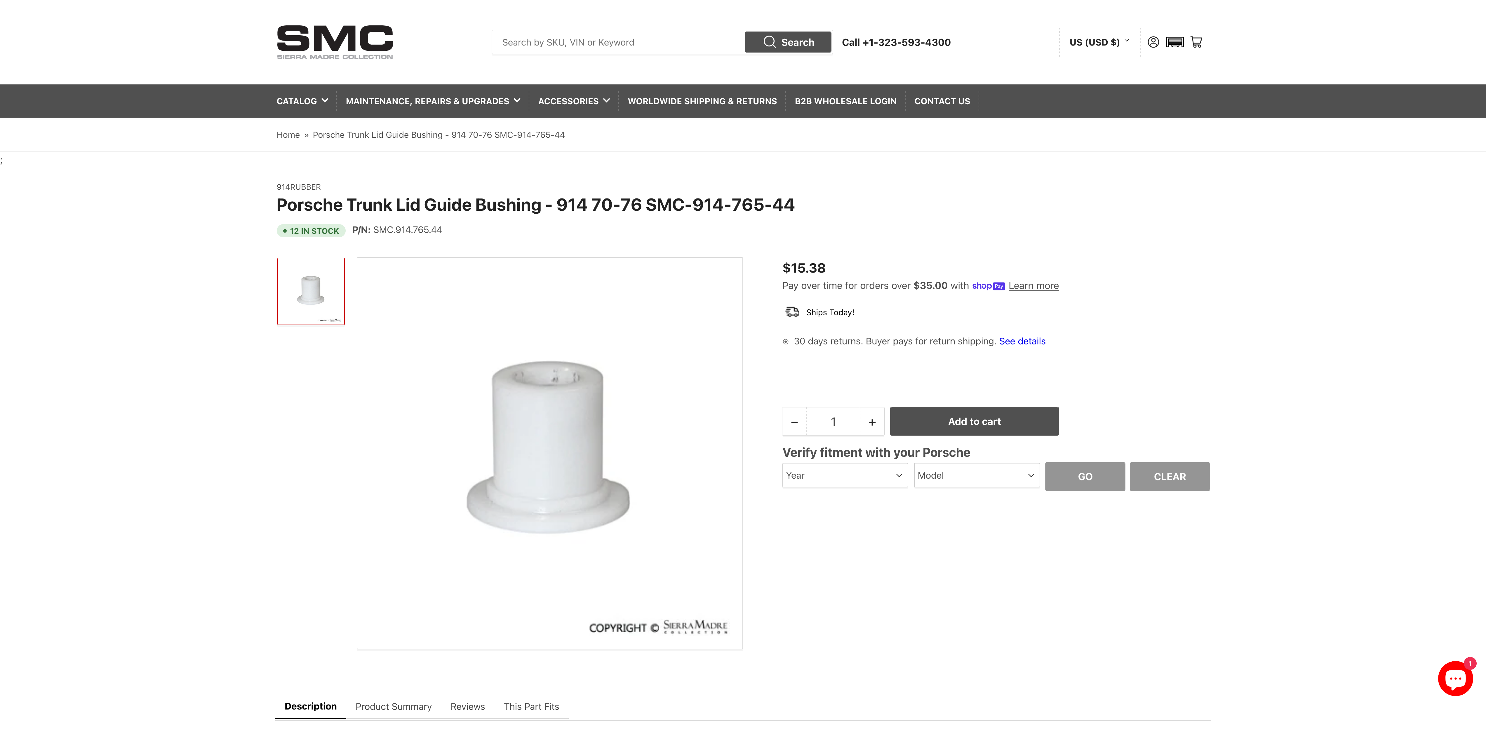

What is the secret to the rear trunk latch spring and bushing? The bushing i have I'm assuming is worn out since it just slides off the post, is there a ridge inside the bushing that holds it in place with the tension of the spring?

here you go

Looks to be an easy fix with new bushing. Thanks

Always cheaper to buy 914 Rubber made parts directly from 914 Rubber:
https://914rubber.com/rear-trunk-lock-guide-bushing
And the send out discount codes for in-house made parts regularly ; )

no secret, the plastic bushing just goes bad. INstall a new guaranteed for life one and be on your way, make sure that you lube the trunk hinge pivot bolts!!!
