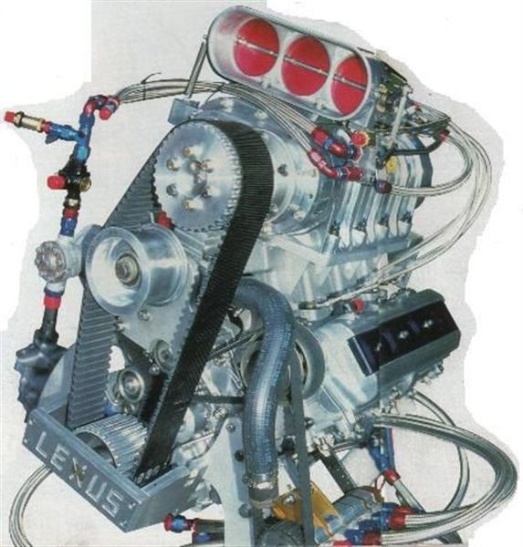

heres a hint:
TravisNeff
post Mar 3 2005, 02:37 PM
Post #72
Posts: 5,082
Joined: 20-March 03
From: Mesa, AZ
Member No.: 447
tractor equipment?
You gonna have to notch your targa bar for something like that to fit. That gives a new meaning to the tower of power
bondo
Post #73
Posts: 4,277
Joined: 19-April 03
From: Los Osos, CA
Member No.: 587
QUOTE (Brett W @ Mar 3 2005, 01:34 PM)
heres a hint:
Oh my.

brett--
OHC lexus v8 motor (IMG:http://www.914world.com/bbs2/html/emoticons/ohmy.gif)

OHC lexus v8 motor
Why what ever could you be referring to? (IMG:http://www.914world.com/bbs2/html/emoticons/rolleyes.gif)
