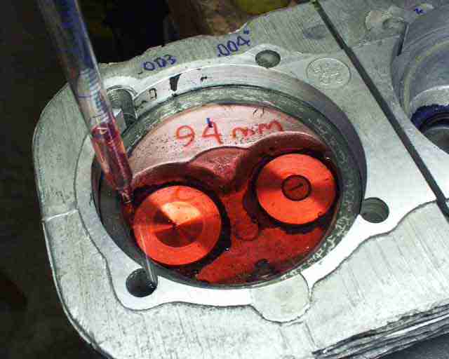

You need a round piece of plexiglass and a syringe or a buret. You measure the quantity of liquid as you fill the combution chamber.

I tried using a syringe and could not control it very well. I just bought a Titration Burette on ebay. Should be here in a couple of days, I will let you know how it works.

i bought a piece of thick plexiglas at home depot and a circle cutter for a drill press and cut my own plastic disk to cc the combustion chamber volume. luckily, i borrowed a burette from a chemistry teacher. i used auto trans fluid but someone mentioned using cooking vegetable oil. i didn't have much trouble with the process. i ordered cylinder spacers to obtain a deck height of .055" (about/recommended)

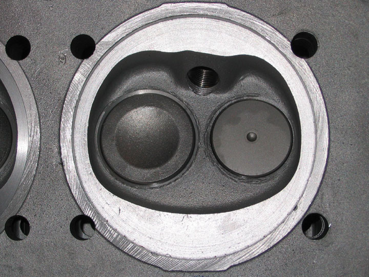

This weekend I got a syringe and made myself a plexiglass disk with a hole in it like MarkV's picture shows. I carefully measured each cylinder and they all came out with a volume of 59cc. Since 60cc had been mentioned as an approximate figure in one of the formulas and since the machine shop notes say it was cut .005", I figured this seemed about right.
Since my deck height was at .022 with the .007 shim in place, I calculated that the height without the shim was .015. Using the AirCooled.net calculator I figured out that I needed a deck height of .065 to achieve 8:1 compression so that means I need a .050 shim.
When I called Jake today to order the shims, he seemed amazed that the volume would be over 57cc. He stated that he'd usually seen these kind of numbers only on engines where the heads had been worked over to create a larger chamber. We reviewed my procedures and calculations and he seemed satisfied that I was asking for the right shims, but then we got to talking about what using .050 shims is going to do the the rocker arm geometry and now I'm worried.
From everything I'd heard, using the Euro Pistons was a simple "bolt in" that would yield a compression of 8:1 instead of 7.6:1 with no other changes to the engine. With everything that I'm going through to get this right I'm beginning to wonder if I just had the wrong impression or if I've missed something.
I really respect Jake's experience and the opinions he has based upon his experience so I want to make sure I haven't missed something. Does this head look like it's been enlarged? Does this description look like I've missed something?
P.S. - When I measured the volume, I used ATF so it would be easy to see when I had all the air out. I held the plexiglass down well. The result looked just like MarkV's picture.
