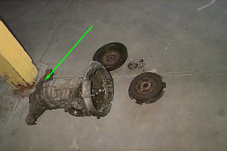

Here is a picture of the ground strap. There is a lug welded to the bottom of the trunk where one end is attached. The nose cone bolts can be seen in the upper right picture here. They are the 3 bolts at the top of that photo. Even though it's a Wevo trans, it will give you an idea of what to look for.
You definitely need this. I forgot to attach mine after reinstalling my engine. It would barely turn over and I couldn't start it. After I attached the strap all was good!
