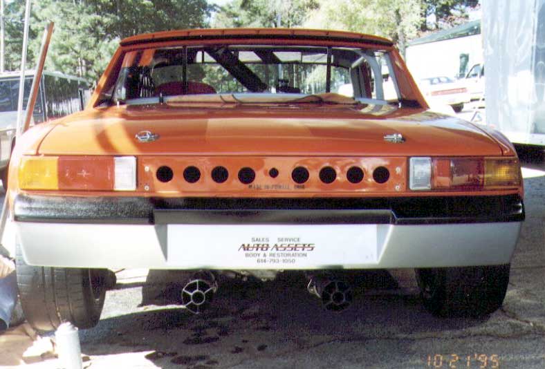

What about something like this ?

That's the process that the book talks about vacuum metalizing. Apparently, a piece of aluminum is atomized (IMG:http://www.914world.com/bbs2/html/emoticons/unsure.gif) and spread over the plastic in the vacuum- very shiney. Then you must clear coat, or you can wipe it off with your finger. (IMG:http://www.914world.com/bbs2/html/emoticons/smile.gif)
