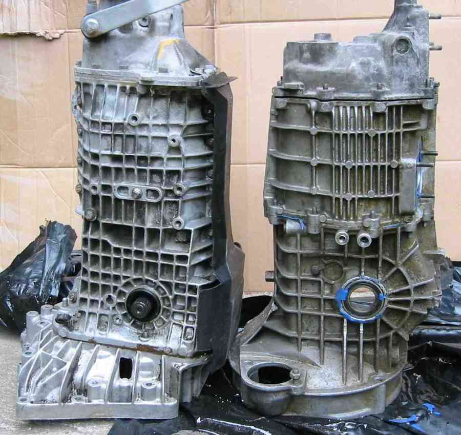

THat renault trani is HUGE!!!
It is not that huge.
UN1 left and 915 right.
914Timo

QUOTE (914Timo @ Oct 12 2005, 05:40 AM)
I dunno about using French car parts.. last time I did that it was a huge mistake. (Pugeot clutch master cylinder in my Mustang.. the Mustang rejected the transplant) (IMG:http://www.914world.com/bbs2/html/emoticons/biggrin.gif)
