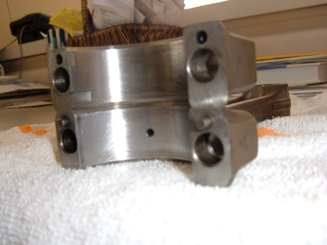

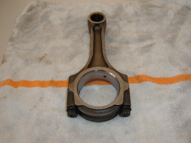

Here's a pic of the 93 - 98 Turbo rod.

Another
I'll, post pic's of the finished product , when finished (IMG:http://www.914world.com/bbs2/html/emoticons/happy11.gif)

You did mention an 82 mm crank, right? Are those rod bolts gonna clear? I know the rods for my 78 mm crank have metal removed there. I would sure like to be at your place when you mock it up. Don't get me wrong i hope it goes but I have concerns with them collideing with the cam and the webbing on the top of the case.

and by placing them on the bottom, you have an engine that must have the case split to replace rod bearings. for an engine that's designed to come apart frequently (race engine) that may be an okay tradeoff. i like the idea of being able to pull a rod with the case together to inspect or replace the rod bearings whenever the cylinders are off.
