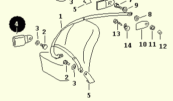

donno about coupes, but in (at least) '70 and '71 Targas, the seat belt mounts were attached tp the seat sliders (outboard) and the center tunnel top (inboard) both using 2 6mm bolts in tension. i do not consider it a very good design. it does have the usual 7/16-UNF receptacle at the top of the B-pillar for the shoulder belt mount.
looks just like this, from drawing 812-00 in the ETKA ('71, Main Group 8, SubGroup 12 (belts))

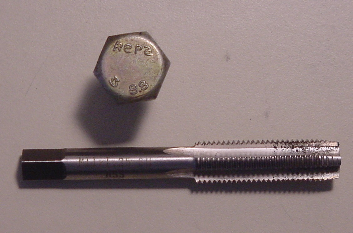

All I know about these is what I have actual experience with.
These bolts are metric. As stated before M11x1.25.
The bolts supplied are Grade 8.8. If they had been SAE, I would expect them to have been grade 5 fasteners (roughly equivalent to metric 8.8).
Refer to the pic below. While 7/16"-20 bolts will screw in, I don't believe the fit is quite the same.
(And yes I do have racing harnesses and use the supplied fasteners)
just my opinion.

7/16" == 11.11mm
i donno if a 7/16" fastener would fit into an 11mm hole, but i bet the smaller 11mm would fit a 7/16".
20 tpi == 1,27mm pitch.
i bet there's enough tolerance in the standard thread profiles that a 0,02mm difference is insignificant; especially when there's a small diametric difference.
i've used my 20 tpi thread gage on the factory fastener and i can't see a difference - 0,02mm is probably too small to eyeball with a cheap gauge.
