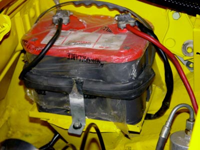

I dont have a battery tray right now. I'm going to buy one and weld it in if an optima gel battery will fit on it. If not I'll just fab my own. Well, will it fit? BTW I did a search and turned up nothing battery related.

Yep, they fit fine.
BUT, the normal red-top has the posts reversed from a typical 914 battery. This is easily cured by putting in longer cables -- fresh cables are not a bad idea at all on a car as old as our 914's.
There is supposedly also an "orange top" with the posts flipped, but I personally have never seen one.

Yes I have Optima batteries in each of my 914s, my 911 and my 29 Ford model A.
Plus if you write to Optima and ask them for a Group 78 adapter it will fit into and hold down your Optima battery using the stock hold down bolt location.

I run Optimas in both my 914s. One has it mounted in the trunk. The other is in the stock location on the stock tray. The terminals are backward but my stock cables worked fine without having to go to longer ones.

i just rotated the optima 180 degrees, werks fine for me ...

They have acid in them, it's just in a thicker form i.e. "gel-cel". The batteries are completely sealed and won't leak unless you put a bullet through it. I use one in my Jetta and Squareback as well. Just flip it around 180-degrees as mentioned.
