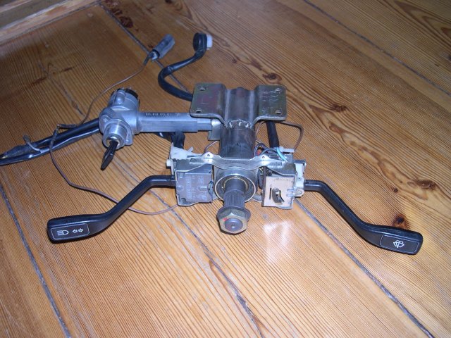

sechszylinder
post Mar 16 2006, 03:25 AM
Posts: 271
Joined: 9-April 03
From: /earth/europe/germany/berlin
Member No.: 545
Hi Mark,
have a look at my conversion. The donor was as well a 84 carrera.
I've welded the original mounting plate of a 914/4 column to the carrera column.
You can use the ignition switch and all other electrical components, but you have to
rewire them, cause the 914/4 connectors doesn't fit to the 911 parts.
Benno
