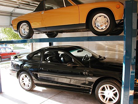

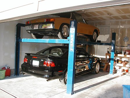

I'm happy with my bend pac, it's a older model, but does the job, plus it's made in the usa, and parts are available should I need them. My ceiling is just shy of 11ft and works well with my two cars. I did need to raise the rails on my garage door closer to the ceiling so that when the door goes up, it still clears the car that's in the air...
