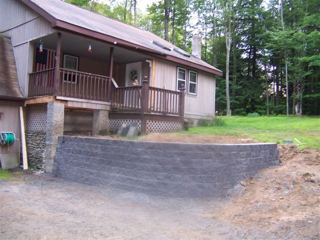

I intended to put pics of the scales and weighing process here as an update for any who were interested but I ended up finishing some projects around the house as Winter is closing in and I need to get my digging done before the ground froze.
The car is up on jackstands again and I won't be weighing again until spring. I will post the process then. ![]() Mike T |

... before the ground froze. Mike T (IMG:style_emoticons/default/av-943.gif) (IMG:style_emoticons/default/w00t.gif) Sorry Mike. Wall looks good. (IMG:style_emoticons/default/biggrin.gif) |

... before the ground froze. Mike T (IMG:style_emoticons/default/av-943.gif) (IMG:style_emoticons/default/w00t.gif) Sorry Mike. Wall looks good. (IMG:style_emoticons/default/biggrin.gif) We will see how Paul laughs when the rain comes and it falls sideways in Florida! |
