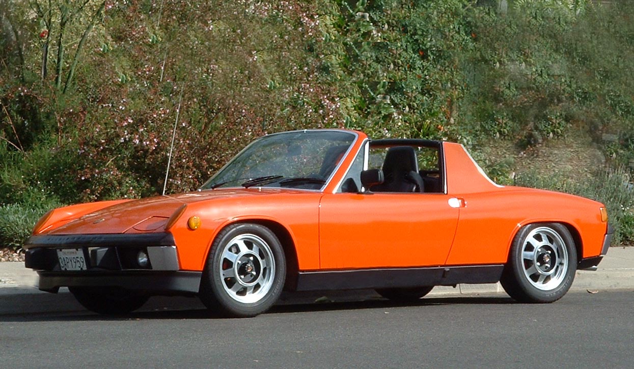

anybody have specific paint name and codes??? as a reference
pete-stevers
post Nov 21 2006, 07:44 PM
Shinee Side Up Prep and Paint
Posts: 2,672
Joined: 10-October 04
From: Abbotsford,BC, Canada
Member No.: 2,914

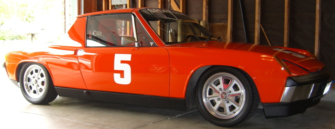

like these two
DanT
post Nov 21 2006, 07:50 PM
Going back to the Dark Side!
Posts: 4,300
Joined: 4-October 04
From: Auburn, CA
Member No.: 2,880
L21E? Looks to be factory Tangerine of that year....1970 1971
Real close to my Phoenix Red...L32K
hmeeder
post Nov 21 2006, 08:41 PM
Dante's Sportscar
Posts: 352
Joined: 21-November 04
From: San Diego, CA
Member No.: 3,154
(IMG:style_emoticons/default/agree.gif) Tangerine L21E

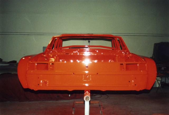

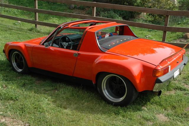

My car is L21E Tangerine or "Blood orange". Single stage....5 coats. Honest. (IMG:style_emoticons/default/aktion035.gif)

Not pinky, but very deep red-orange.
Dekman's top pic is as close to a perfect color rendition of Tangerine as I've seen on the internet.

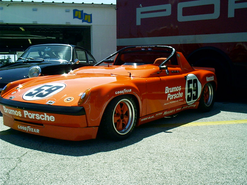

Is the '59' race car at the top of this thread Tangerine as well ? Looks a bit lighter but may just be the lighting

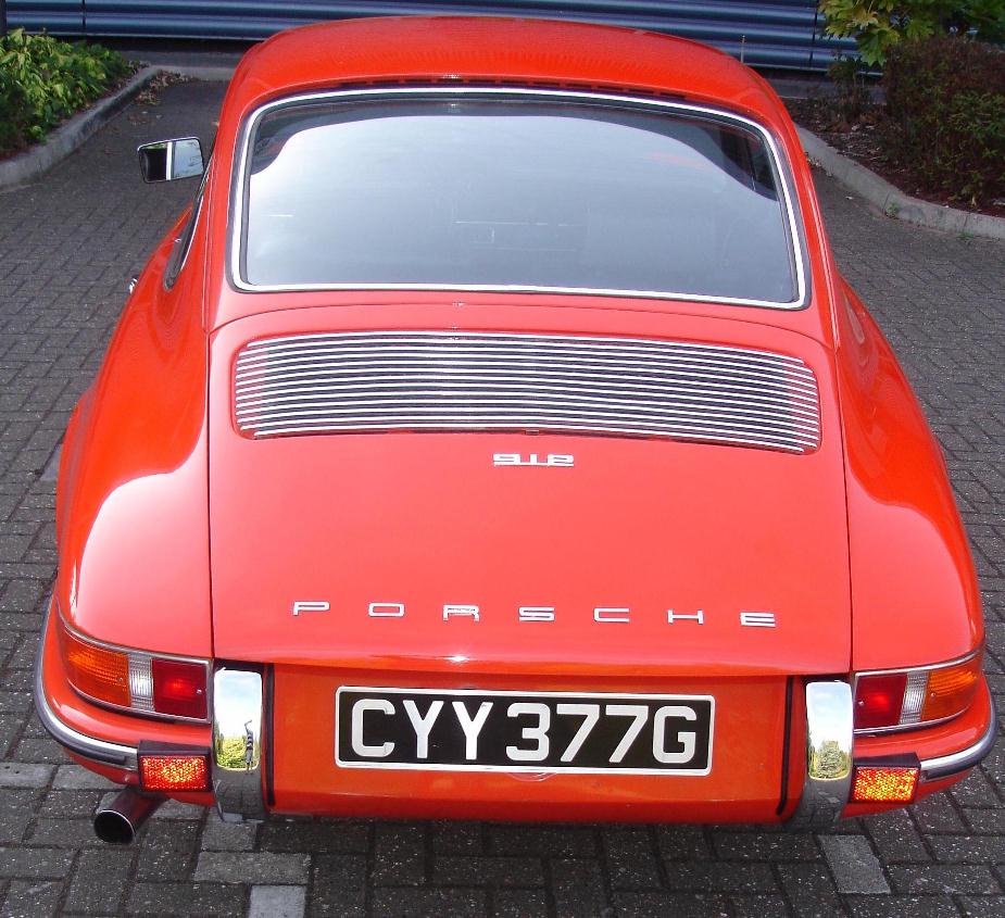

Tangerine is one of those colours that can look totally different depending on lighting conditions.
Here are 2 pictures of my original paint Tangerine 912 taken on 2 different days:

I had a close look at 5 Brumos 914s at the first Rennsport Reunion. They were all definitely Tangerine.
