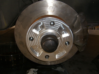

You do not have to go to 5 bolt to get vented rotors.
You will need to go to 5 bolt to get 4 piston calipers.
I did M calipers on the front with vented SC rotors using the magical mythical Billet 4 bolt front hubs.
M calipers give you plenty of braking and the vented rotors keep the brakes from fading for 30+ minute sessions. You don't need to use the brakes much on a 4 cylinder 914 (IMG:style_emoticons/default/biggrin.gif) say to yourself....momentummmmmm, momentummmmmmm (IMG:style_emoticons/default/driving.gif)
These brakes work great...with stock rear brakes and removing the bias valve and replacing it with a T.
