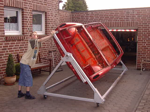

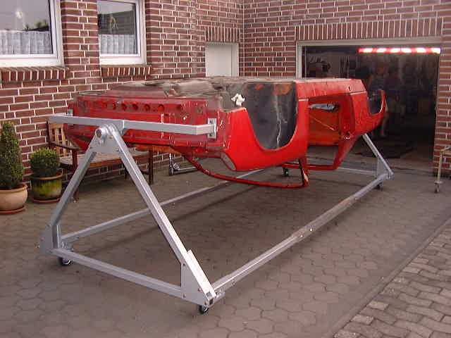

I visited the site that DEC listed. Check out the nice 914 rotisserie. Thank you, DEC.

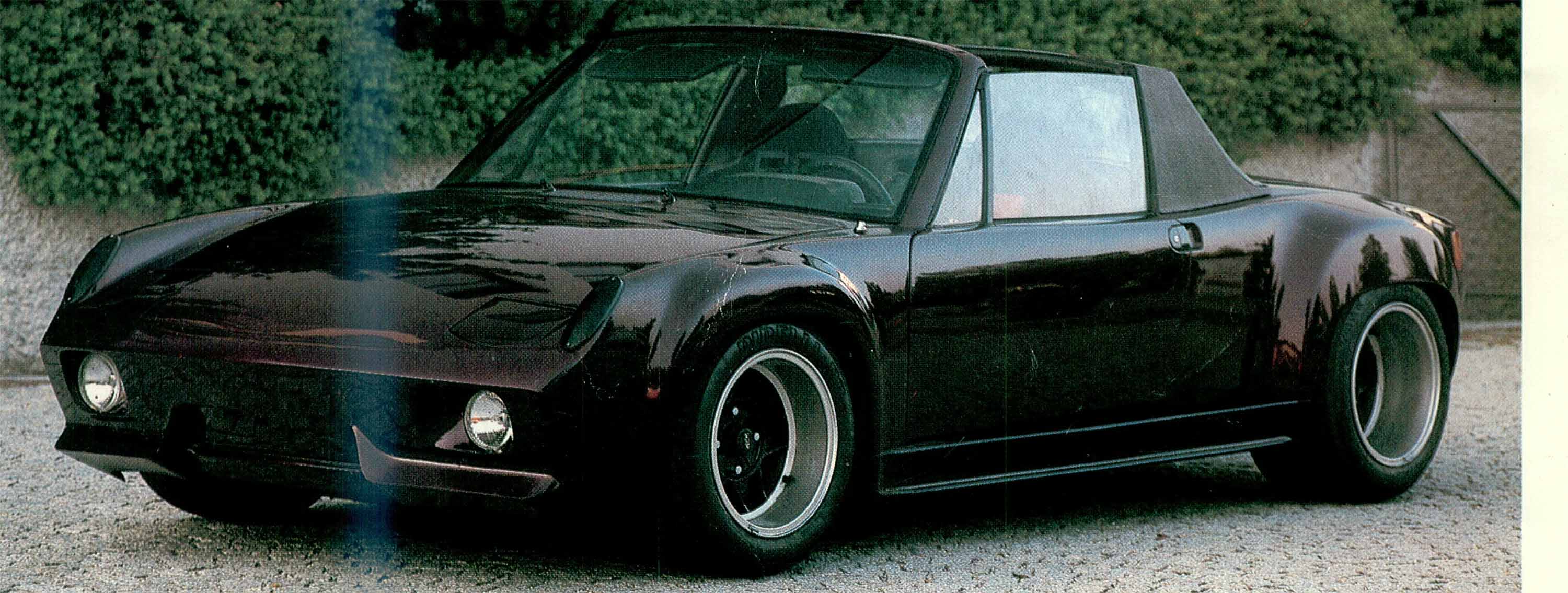

here a pic with 9" on front and 11" at rear
