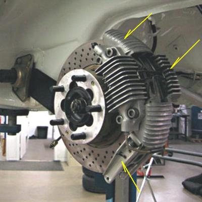

You could go with stock 914/4 or 914/6 calipers. You can widen either one for vented rotors and keep the stock parking brake.
If you like a lot of work you can fabricate the 911 drum brake setup with vented rotors.
Or you could fabricate this style of emergency brake from the RSR:
