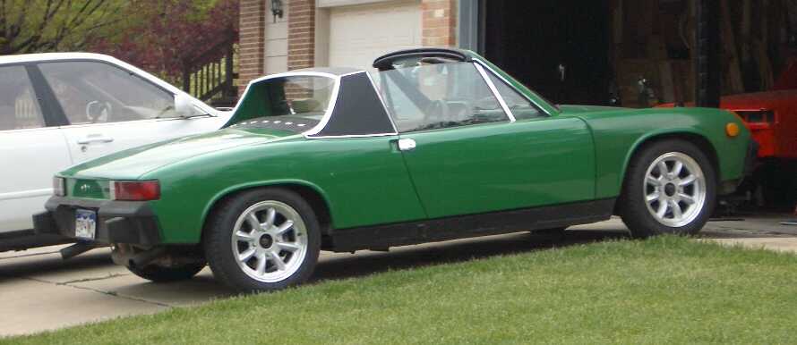

Interesting info...
Does anyone know if Mini Lite still sells these wheels?
15" x 6.5" and same offset as the Fuchs 2.0... weighed maybe 16 lbs.
Michelin 195/60's fit perfectly with no fender mods...
Could have gone to 205's in some brands, w/o interference...
Mini Lite sold the correct lug bolts, with a thrust washer, to fit the flat holes...
Seems like they used to be about $155 each, but everything has gone up lately...Attached Image

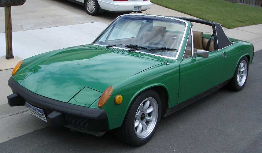

It's been a long road...
My $360 deal on Superlight wheels ended up costing $900 by the time it was all said and done. If I hadn't broken that one wheel, I still could have come in under the $750 shipped cost of a set of new wheels from Superlight.
But, these are now custom 30mm offset wheels. My new bolts are even long enough with these wheels for some spacers in the front. I may still add them. We'll see...
Pictures came out pretty crappy. The clouds (and work) rolled in before I could get some decent shots.
