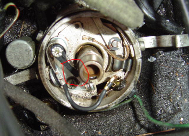

QUOTE(Bleyseng @ May 17 2007, 12:17 AM) *
Those points look worn out... toss em and get a pertronix or crane points replacement.
From the pic the cam block looks like it s gone. (IMG:style_emoticons/default/blink.gif)
No more help from me until I see a bigger avatar pic. (IMG:style_emoticons/default/chairfall.gif)
Or how about just buying new points? (IMG:style_emoticons/default/confused24.gif)

I trust Geoff's assessment that the cam is gone in the dizzy, I can see how it looks that way. This would make new points useless (thought I would say pointless (IMG:style_emoticons/default/biggrin.gif) ). I am with the pertronix crowd. Do a search on ebay, and google. I know I have seen them for around $60 reacently.

Hold on (IMG:style_emoticons/default/WTF.gif) you're telling me there's an entire part missing???? (IMG:style_emoticons/default/blink.gif)
Points and condenser are under $10 a piece, which is my kind of parts pricing, so I'll call and see if my local guys have them and I can put them in today.
(IMG:style_emoticons/default/smash.gif) (IMG:style_emoticons/default/sawzall-smiley.gif) (IMG:style_emoticons/default/stirthepot.gif) (IMG:style_emoticons/default/welder.gif) and then hopefully not (IMG:style_emoticons/default/headbang.gif)

looks like the cam block (circled) on the points is worn out or gone. Get new points, set them to .016 gap when the cam block is at the high lobe of the dizzy shaft.
Retime the motor using a timing lite
also CLEAN OFF AL THAT GREASY GRIME OFF THE ENGINE!
It will run cooler.... (IMG:style_emoticons/default/chairfall.gif)
