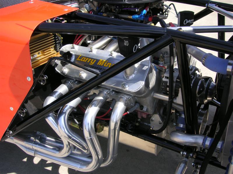

Attached please find one of our headers custom made by a gentleman out of Arizona. Any size you want. He vists us and generally makes six sets at a time. I love to watch this guy work.
Don't forget the intake!
Dan
