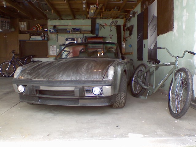

Where are you mounting your headlights?
I mounted KC hilites in the foglight holes, they do not have a high beam but are so much brighter than stock. They really work great and since I live in wyoming I really don't have to worry about getting busted for dot violations!
Sorry for the crappy cell phone pic:
