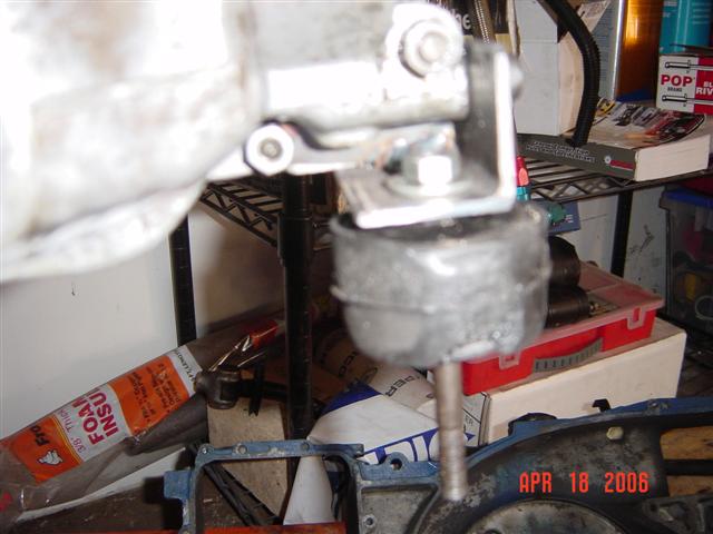

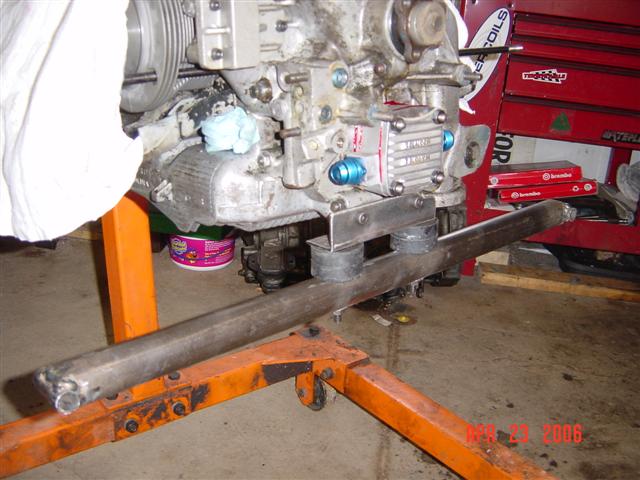

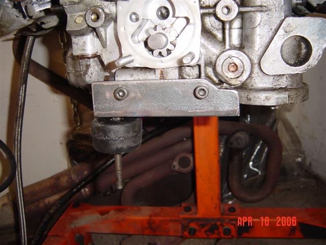

Here's a shot of my simple attachment. Note that the bottom of the case rests on the angle and there's a small bracket that reaches back to grab another case bolt (fuzzy picture).
Also, note that this isn't my current arrangement. I've done away with the rubber mounts, but not because they didn't work, for other reasons.

Kevins bracket looks good to me. Kevin I thought you only had two bolts holding yours on. Glad it's really three. When looking at the first photo Kevin posted my bracket looks like his, but I welded a vertical piece of angle to the passenger side of the horizontal angle that bolts in at the original bracket upper mount boss. I first slotted the vertical piece so the pipe nipple passes through it.
