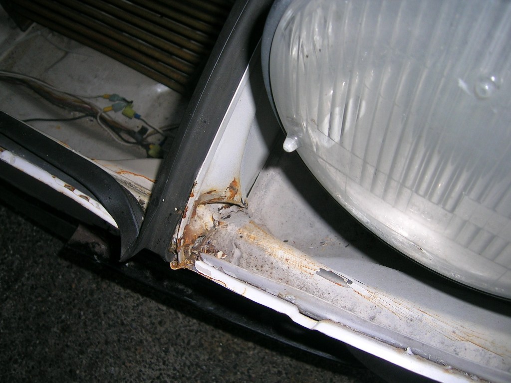

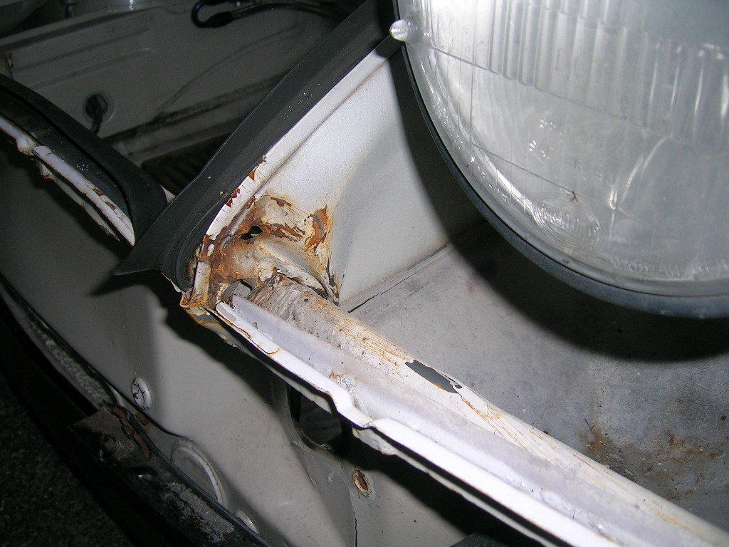

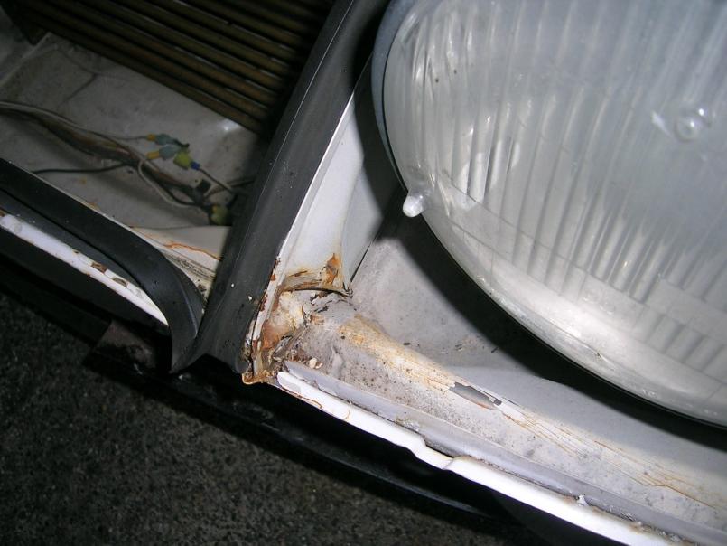

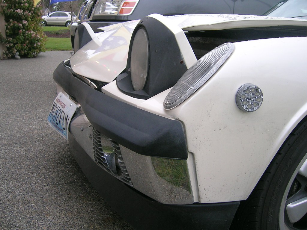

Had a minor fender bender a few weeks ago - my front bumper to SUV's trailer hitch. No damage to the SUV, but my mint chrome fender is toast, as is the hood. The body just behind the bumper is pushed in. It doesn’t appear to go down as far as the spare tire shelf, so I don’t believe the frame or alignment is affected. Headlight buckets are creased, left worse than right.

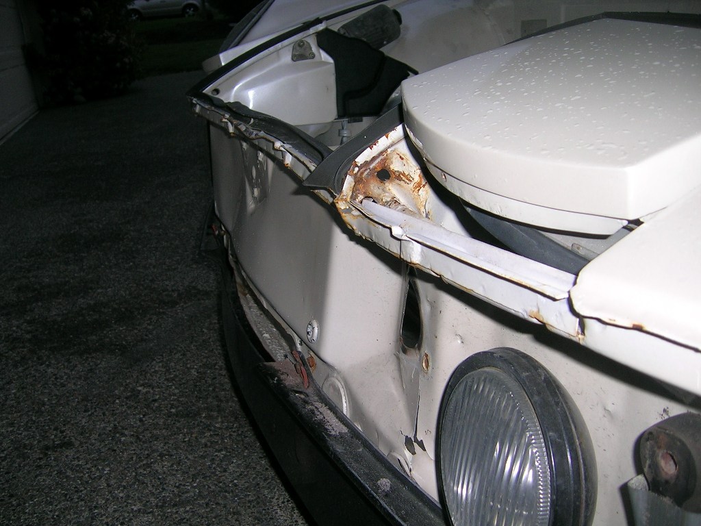

Right headlight bucket:

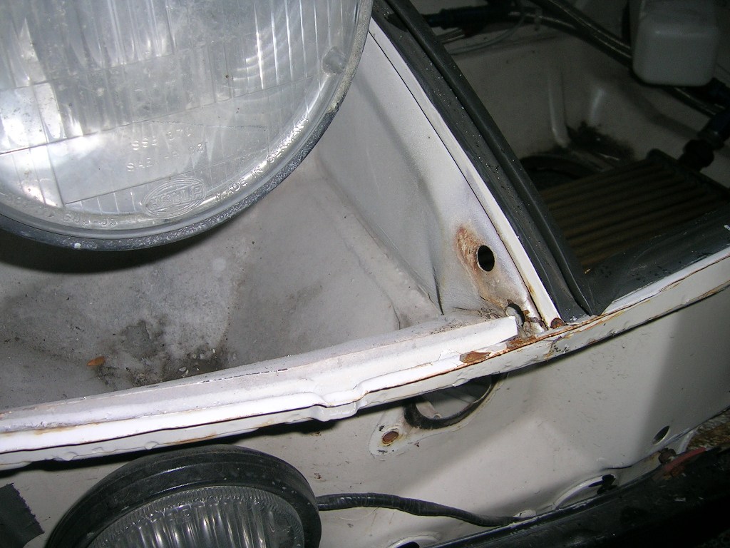

Left bucket:

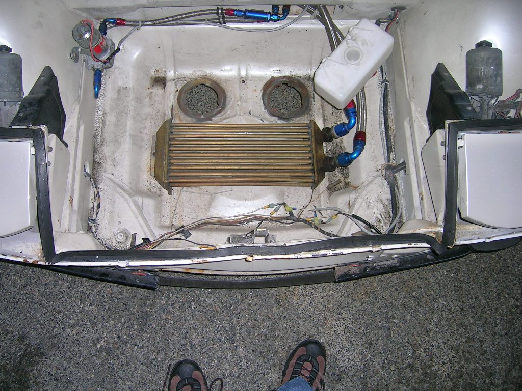

View from above:

The adjuster came out last week - reasonable guy. Recommended a local shop that apparently used to be the porsche audi body shop - Boesen Collision on 74th.
I sent pictures to a board member who is a retired body guy - he recommended putting the car on a frame machine to make sure there is no further damage. I don't know of anyone in the PNW with bench. I was a pretty low speed accident - probably 5-10 mph.
It will be an insurance job, but there are a few other body items I wanted to get done and want a shop who will work with me: match rear valance and rocker covers to the rear 911SC flares, adjust door openings (1/8 inch too short after installation of rollbar), make a cover for the 911 cooler in front trunk (could be same shape as the spare tire cover), mount 911 mirrors, fix ding in driver’s door, remove diagonal from rollbar (takes away too much passenger legroom), make proper brackets for front and rear camp914 hood shocks, delete antenna hole.

Damage doesn't look too bad and glad to hear your getting it fixed right. Keep us posted. I don't know of any decent body guys anymore.

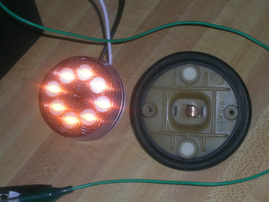

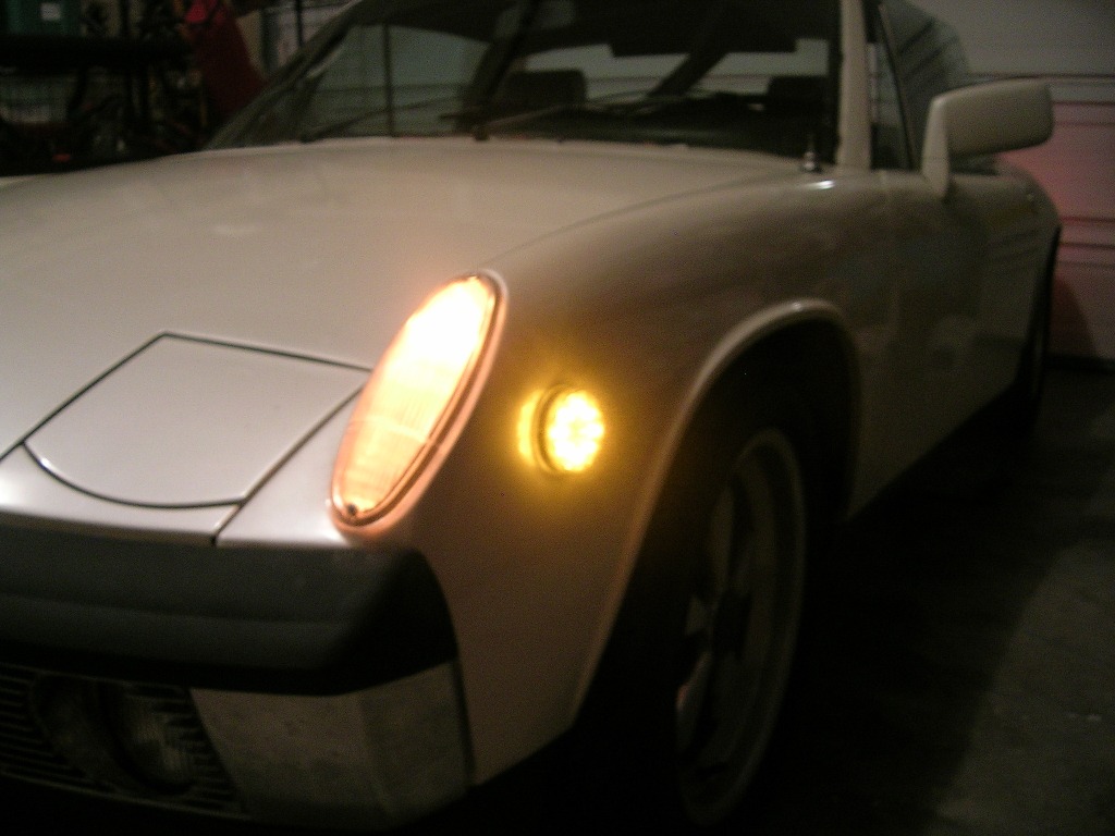

Hi, sorry about your accident, good to hear nobody was injured. Sorry, timing might be off here........but can I ask you about those cool front turn signal lenses and side marker lights....where did you get those? They are awesome!! I need something like those in clear like that. Are those Italian? Thanks and cheers

No worries. Italian turnsignal lenses. I sanded the buckets, resprayed with chrome paint, epoxied in new 1157 sockets, and used amber 1157 bulbs. Turned out pretty nice.
For the side markers, I used clear lensed, amber LED side markers. Made by a company called Maxxima. Got 'em off ebay for like $6. Drilled holes in the proper places to epoxy some nylon threaded studs. They're pretty bright and are about 1/2 inch smaller in diameter vs. stock. I like the side markers vs. not, as I think they improve visibility of me at night. They even look pretty correct vs. stock.

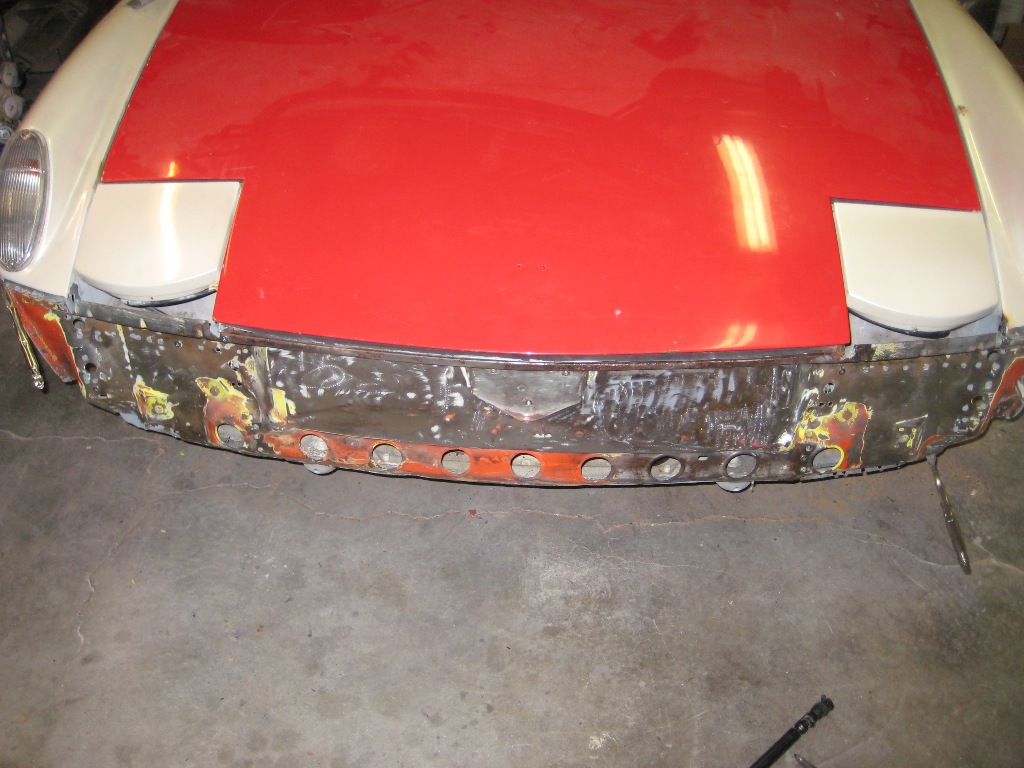

Well, the repairs begin! I ended up going with a guy who advertises locally on CL. He's factory trained and didn't flinch when I asked about flaring the rockers and rear valance, fabing a front trunk floor to cover the oil cooler, and fixing a few other things not related to the front clip. It's pretty dicey to make WCR, but we'll see. Will post pics as I get them:

(IMG:style_emoticons/default/beerchug.gif) Looking good so far. Keep us posted.

Looks good. Hope he get's it done soon so you can enjoy it a little during the summer.

Thanks Craig - will do. That front clip looks good recycled (IMG:style_emoticons/default/smile.gif) .
