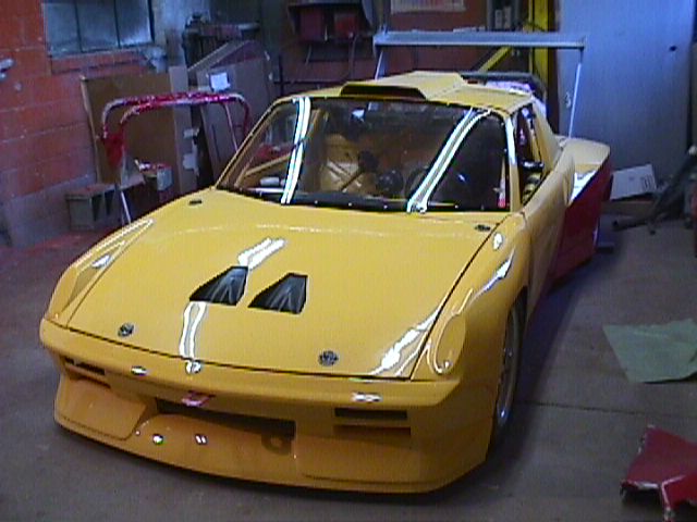

I am thinking again about a v-8 conversion. I was trying to think of ways to minimize the cutting of the tub for the radiator install...I'm not too keen on chopping on the inner fenderwells (for escape air). I have seen guys vent the radiator through the top of the hood, but rarely does it look sanitary. I found this pic. The guy is venting his oil cooler, but would a series of (maybe larger) NACA ducts do the trick for the radiator?...obviously more surface area on the radiator...let me know what you think.

i like it. i'll do the same for my front oil cooler.
but, i have to warn you. pretty much everyone else (including brad) hates it ...

paint the ducts in body color and they'll even be pretty! (IMG:style_emoticons/default/wub.gif)

i think it looks purposeful and mean (IMG:style_emoticons/default/aktion035.gif) . Not that my tub is pristine, but I don't want to cut anymore than I have to......if I decide to go the V8 route.

I like it. It reminds me of what use to be done to the Panteras to help with cooling.

He nailed it. Everyone "talks" about how they like the look... ever notice that you dont see any street cars done this way (914's) ?? All the cars that came stock this way have solid tops that dont come off (and the heat still comes in the windows)
Jridder,
That Pantera radiator is good for one car (the Pantera). We beat the piss out of a V8 914 at Thunderhill last year (open track day) and only the oil temps climbed past unsafe (Renegade radiator properly installed) 3 drivers.
Exit the floor or the side wheel wells.
My .02

Some say it can raise the car (lift).. but I doubt it. Every Corvette and Z28 out there exit the air underneath the car.
The other method is out the inner fenderwells. I dont really like this.. but I feel it is the cleanest setup and has proven itself as a solution for 30+ years on all the V8 conversion cars...it does however compromise the factory "crush" zone they built into the inner fenders.
