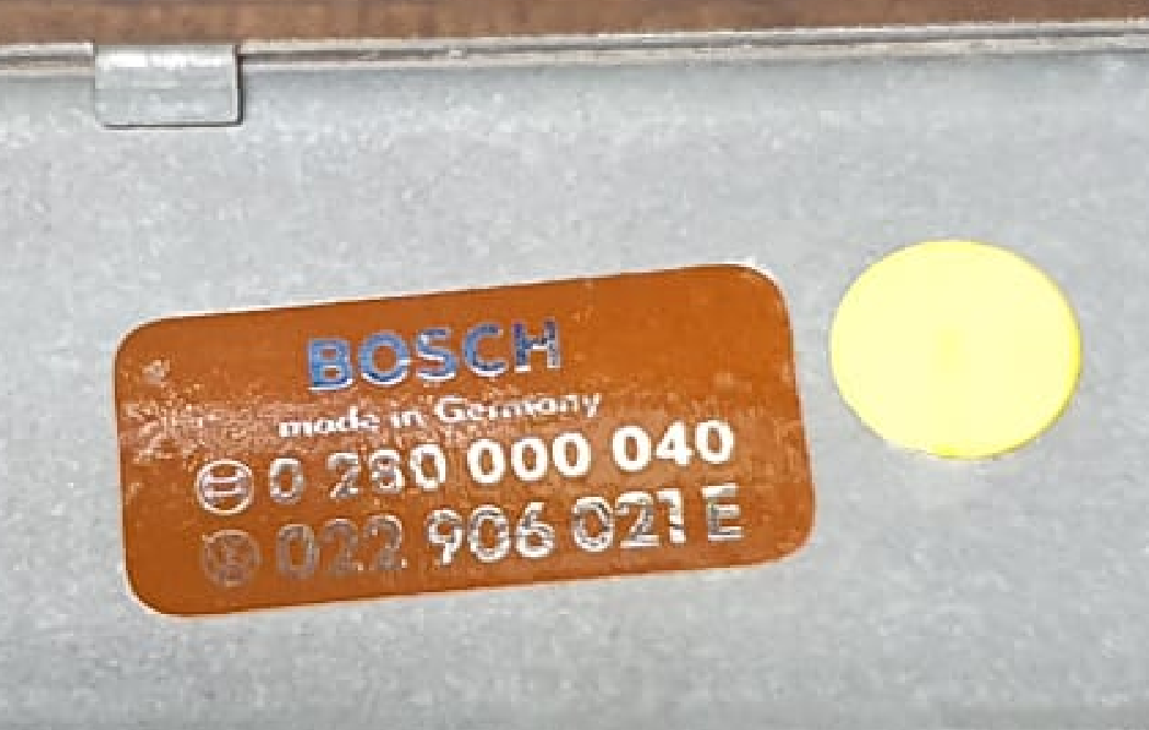

I have another ECU in good condition to test – but it’s an 0 280 000 040, not an 037. It does have the same VW part number - 022 906 021 E. According to the info I found this is also supposed to work with an 037 MPS…
