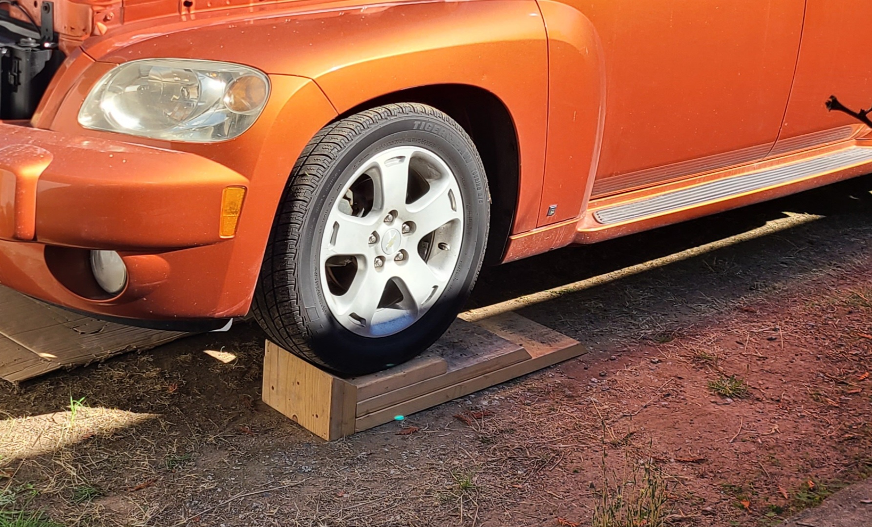

post Oct 24 2025, 10:26 AM
Post #23
Posts: 61
Joined: 4-June 20
From: San Jose, CA
Member No.: 24,349
I made ramps out of 2x10's:
BillC

rjames
post Oct 24 2025, 12:10 PM
Post #25
I'm made of metal
Posts: 4,447
Joined: 24-July 05
From: Shoreline, WA
Member No.: 4,467
QUOTE(808 WRX @ Oct 24 2025, 09:26 AM) *
Exactly what I did. Gets the car up just high enough for me to get my fat head underneath along with the the oil catch container.
