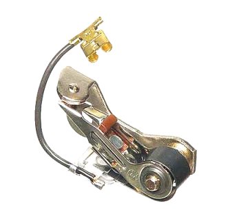

The points (pictures above) are a mechanical fixture inside the distributor, under the cap and the rotor. These points work in concert wiht the condensor (looks like a little beer can on the side of your distributor) to tell the coil when it should shoot out a spark.
If your points are not "gapped" correctly, this whole orchestra will be off and you will get no spark. Gonna have to read the manual pages recommended aboe for more info on the gap.

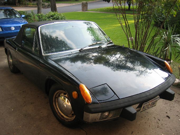

Oh, and here is a picture of the car for those who care to take a look at its current state.

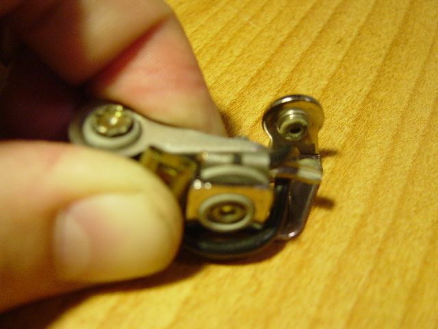

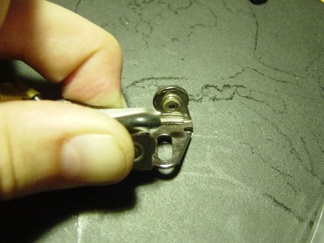

So, here are the pictures of the points I removed. Anyone know if the hole in the base of the points is normal? Is this record breaking pitting, or do some points look like this when you buy them?
Let me know what you think, folks.

(IMG:style_emoticons/default/confused24.gif) Dunno if any came that way, but certainly none that I have seen.
