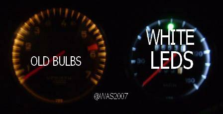

You might Get a set of LED while you're at it. It increased my instrument lighting by 100%.

The LEDs run on 2.7 volts, so if your grounds are not 100% you may only be getting 10v to your lights. With an incondecent bulb, it will burn yellow. An LED will be full spectrum and make the gages look white instead of yellow.
Just some food for thought.

This is the same set of gages in Mikey's car, you can really see the difference.
