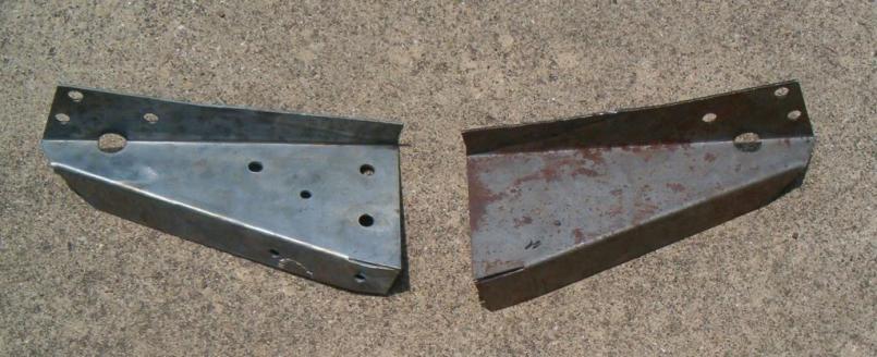

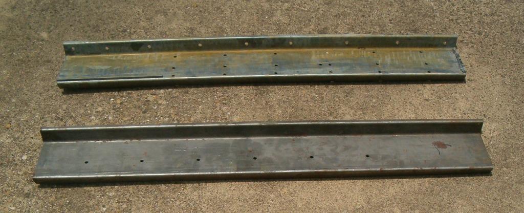

I got mine from Brad Mayeur at 914ltd.
THIS is the one you WANT.
it ties the suspension to the long for more rigidity. great product.

I am sure Brad makes good stuff. anyone have pics of his kits?

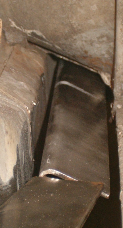

Unfortunately it looks like "the turd" has a sag problem on the drivers side. I think there's rust inside the long but it hasn't made it's way through to the outside. The bottom seam flexes a little. I need something to "clamshell" the rear portion starting about 10" in front of the jack point and extending back to where the long curves up. Andys came through with a couple of pieces of stock that might work. I'm going to spend the day tomorrow cutting, grinding & welding.

Here is a few pics of one of Brads older kits with a few of my own modifications...
Im the last pic you will see a gap between brads kit and the top of the long - This
is where I addes some additional 1/4" square rod to brad kit to fill the gap, later
welding this area as well -

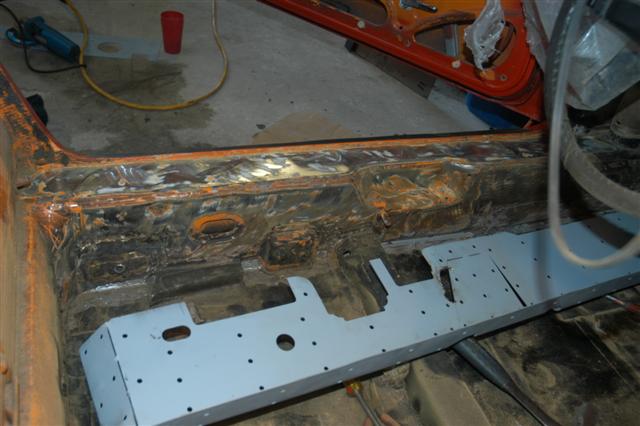

I went to both extremes - I welded Brad Mayeur's kit to the external of the longs "after making sure/making rust repairs" to the original longs. In addition, I welded the inner stress kit into my car. I believe without checking the kit belongs to Engman but check the suppliers listed either on this board or the other one to ensure I am right. I maybe giving credit when it belongs to someonelse. They both work together quite well.
I purchased another outer long stress kit but do not remember who made it. I believe it was the sheet metal parts provider who was recently bought out by someone from Canada.
Hope this helps.

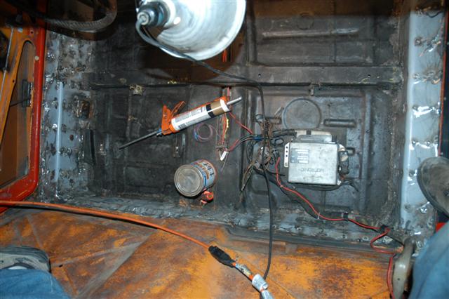

QUOTE(Heeltoe914 @ Oct 23 2009, 09:27 PM) *
Steve what is your purpose? Are you looking to repair of stiffen the chassis? I for one think the inside eggman??? Are the best IMHO.
Got any more pictures of you putting in the long stiffener? What are your thoughts on if you had to do it again... Would you do it the same way? Did you do the back first and connect the two sides? Did you do two sides and connect the back? I also see you have some epoxy or sealer or something in your pictures. Whats that for? = )
Please tell all.
Eric

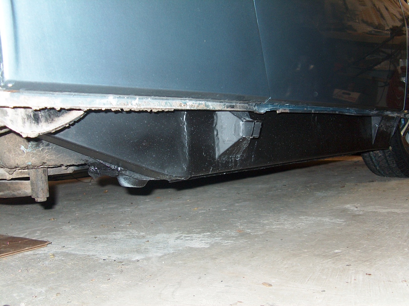

Grelber
post Oct 24 2009, 07:57 AM
Insert favorite Don Rickles joke here.
Posts: 690
Joined: 30-May 06
From: McKinney, Texas
Member No.: 6,107

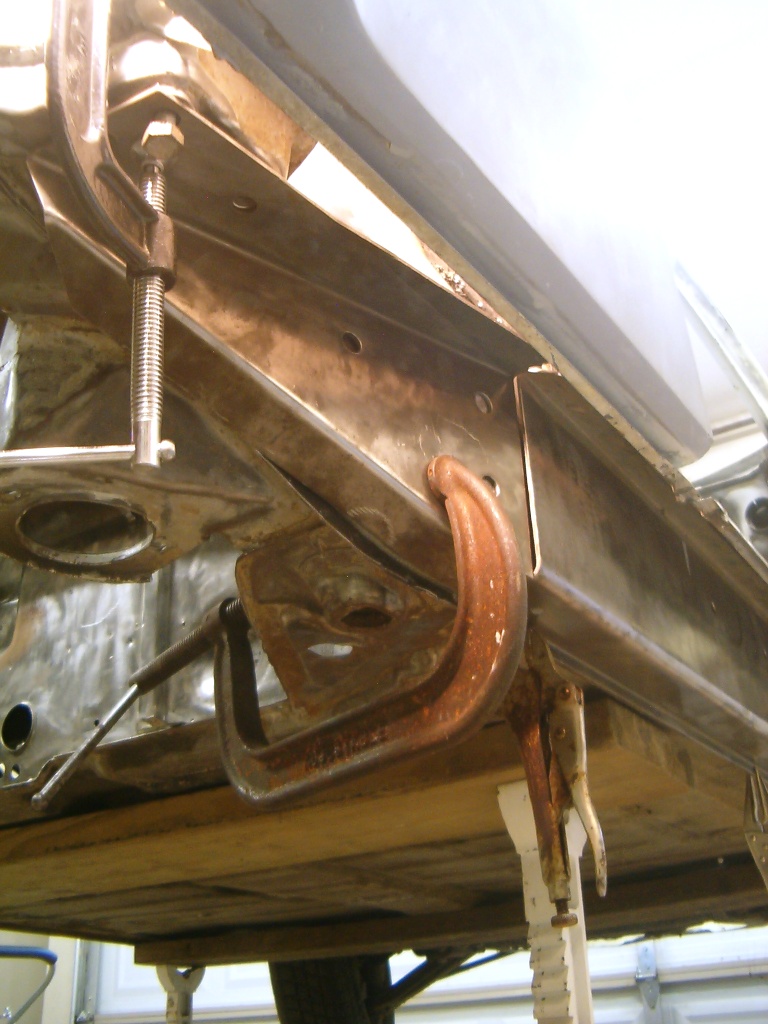

Here's a pic of my passenger side with the Brad Mayeur long kit welded in, and painted, etc. We put the new jack posts on as well. I also put in the Rich Johnson rear console stiffening kit as well (way overkill, but hope one day to have some serious horsepower).
Cire
post Oct 24 2009, 08:49 AM
Posts: 279
Joined: 12-March 09
From: Tucson, Arizona
Member No.: 10,155
QUOTE(Grelber @ Oct 24 2009, 06:57 AM) *
Looks great. Did you do the work yourself? Do you happen to have more pictures? How much was the Brad Mayeur long kit? How long did it take you to get it welded in? If you had to do over would you stay with the style you selected or would you go to the internal long stiffeners? I had 30 more questions but I will slow down a bit. = )
Thanks again for the great info. = )
Eric
