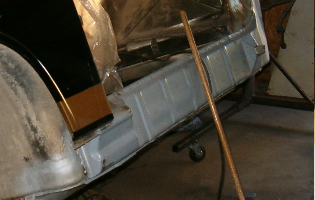

I think some of you are missing the difference between the restoration parts that AA and GPR sell, and the Brad Mauyer kit.
The former is for replacing the rusted panels in a stock long. The Brad Mauyer kit is for reinforcing the long.
The stock long looks like this:
Or if you want to picture it, like a piece of corrugated cardboard with the outer layer peeled off. You see the wavey cardboard underneath.
What Brad Mauyer's kit does is to put the outside on the wavey metal. Now it is truly like the corrugated cardboard. And despite it being just paper, corrugated cardboard is stiff.
The long after Brad Mauyer's kit:
It adds so much rigidity that the top on my car doesn't squeak, and hasn't in 5 years. Plus I can stick a jack under the rear donut, and both wheels leave the ground at the same time.
The only problem I have with the Brad Mauyer kit is that I had to grind a notch into it to clear the oil suction hose from the factory oil tank.
It is HIGHLY recommended.
