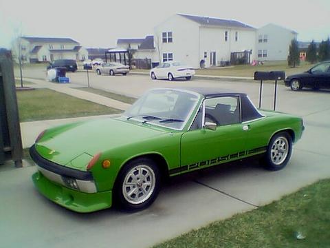

Here's a pic of my car as it sits right now. One of the reasons I used such a dramatic front spoiler was to plant the front end down (and I thought it was cool looking)... but if I drop the front end more, I'm gonna have to drop the back end as well.... as the back end already sits a tad bit higher than the front anyway.
If I drop the back, do you think I'll run into tire clearance problems?
I'm worried about drop[ping the front too much, as I'll turn my teener into a snow plow (IMG:style_emoticons/default/laugh.gif)

You may turn your 914 into a snow plow if you lower the front end. But aero doesn't do much for a 914 at any kind of sane speeds for the real world, so a huge spoiler like that is a waste IMHO. Lowering the nose will definitely give you more front grip, and it should reduce body roll slightly.
Lowering the rear shouldn't cause tire fitment problems that weren't there to begin with. Probably.
