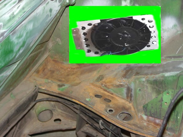

Has anyone installed an oil cooler in the battery tray/hell hole area?? I was looking at this area and thinking that if the battery is relocated this spot could be used for an oil cooler/fan combo with the hot air being spent into the passenger side wheel well. Keeps the oil lines close and keeps both trunks unaltered (except for relocated battery!). I don't know how much ambient flow would occur with this installation, but a fan(s) should be able to push enough air??
Here's a really quick and really bad photoshop pic of what I mean:
My apologies to whomever I stole the hell hole pic from....it's not easy being green (IMG:style_emoticons/default/laugh.gif)

I'm not sure there is enough airflow or space for an adequate size cooler in that location.

correct me if I'm wrong, but if you are going to put a scoop in the body to make the oil cooler work in the hell hole... isn't that MORE cutting and noticable than the front trunk?
I've seen guys mount radiators(larger than oil coolers) in the front trunk without HUGE cuts... and the fron trunk can be repaired fairly easily if you want to go back...

Yes.. cutting into the fender is cutting...
but without it you can't pull in much clean air.
the problem with that area is that you won't pull in to much air (none clean) through the engine grill...
plus your fighting the engine for air
plus the hot air exit will be re-filling the engine intake with pre-warmed air...
So what oil cooler/and what air flow did the factory use on that 3.6engine?
If they felt it needed a cooler in a clean air path then it probably does...
you don't have to totally waste the front trunk if you do it right...
talk to someone who has done a 3.6 conversion... (I haven't).. but I'll bet they require a front cooler.
all that would do is push hot air over hot oil.
why? (IMG:style_emoticons/default/confused24.gif)
you want a external oil-cooler? mount it where it gets enough cold air to actually DO something for you.
the front is the only way to go.
those little electric fans won't help ya cause you still move hot air over a hot cooler.
same for the under-rear-trunk location.
or the inside-rear-trunk location.
this just does not work ...

I'm sorry guys, but your losing me on the "hot air" reason. Doesn't the engine get it's "cold" air from the engine grill, why has it all of sudden become hot air?? The factory built in engine oil coolers rely on this air source and from what I've read in other threads it's perfectly adaquate for even up to 3.2 liter motors without an external cooler.
As for the comment: "plus the hot air exit will be re-filling the engine intake with pre-warmed air..." Maybe you miss read the air flow, it would be dumping out through the fenderwell and away from the engine bay.

I have a mesa cooler there with a permacool fan pulling air into the fenderwell from the e bay. It heats the fender up real well! (IMG:style_emoticons/default/huh.gif)
I couldn't tell you how much effect it really has though, my car is a four and doesn't run real hot. On a long freeway (~75mph) drive last weekend in 85 deg weather my temp guage never hit 12 o'clock with it on.
It is a convienient place to put one though easy pluming!

Dman......Cool install, that's kinda what I had in mind. I figured it would require a heat shield in the fenderwell to keep from cooking paint and making the fender hot to the touch.

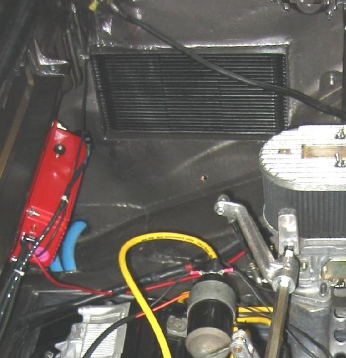

How about something like this:
(IMG:http://fly.hiwaay.net/~jonlowe/MVC023F.JPG)
Get the oil cooler mounted at angle in the rear passenger fender with ducting to route the air flow. Some mech screen to protect the cooler from road debris . As for the air intake, one from a boxster grafted into the fender.
Come to think of it, it's probably about the same price as fitting it up front.
I did see a 914 with a boxster air intake on the passenger side rear fender. The guy had flared the rear fenders during the process. It look pretty good IMHO.
