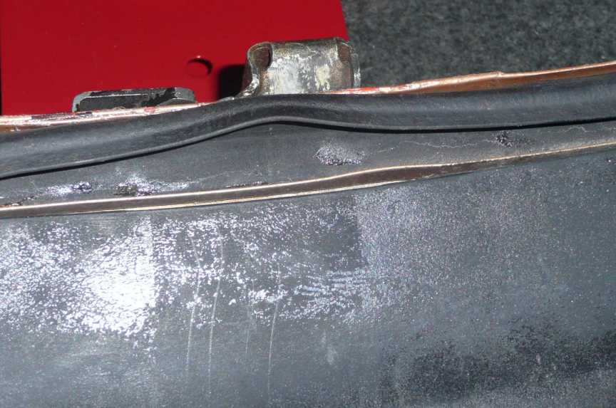

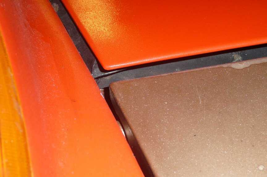

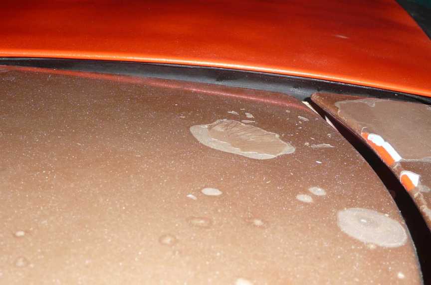

Installed an oem front hood weather strip and it's puckered up at the front and rear center, from being folded in the plastic bag. All the way around it won't lay flat, causing the hood to ride about 1/8" up above the fender line. It's been on the car for about a month.
How can I get my rubber to go down and lay flat. (IMG:style_emoticons/default/blink.gif)

I see a bent/deformed seal track. I also see pre-load in teh center(pushing in from teh edges). straighten the track and re-seat the seal starting from teh center and work out toward teh corners

Yep. It was folded in half at the top and bottom center and then folded right into the bag. I've taped it down for weeks at a time and it still comes up when the tape comes off. I stretched it from the center and it puckers. The flat bottom in the track is not puckered. Only the upper rubber seal part. I guess it was packed when still soft and got a bent memory. I'm going to get some 1/2" foam insulating tubing and glue it inside the fold area just to keep it flater and more watertight.
