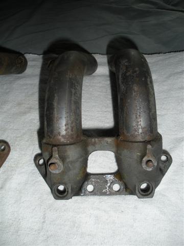

PET 117-10 #(20) intake manifold 1.8
PET shows that L and R are different

QUOTE(type47 @ Nov 16 2009, 07:03 AM) *
Playing with some 1.8 runners this weekend. Yes, r&L are different

Tod914 had a question on that other post of his on intake runner colors, if the 2.0 were different as well?
My guess is yes, because of the alternating position of cylinders L to R on all Type IVs, relative to a more or less static central throat & air leaner position for all of the various displacements - 1.7 (EA/EB/EC/W?) & 2.0 (GA/GB/GC) & the 1.8s.

2.0, 1.8, and 1.7 runners are all different.
L & R runners are all different.
