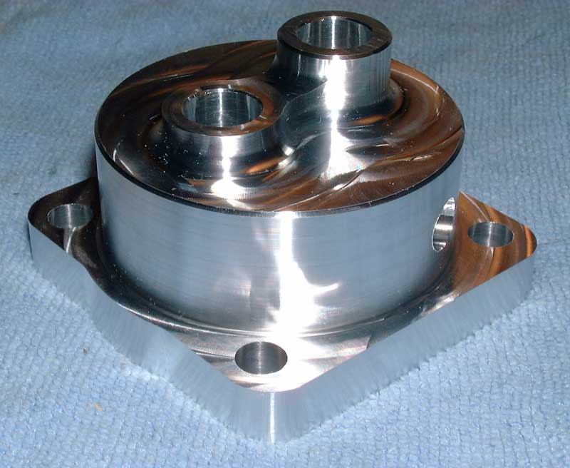

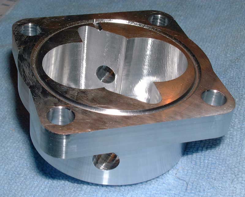

Jake Raby
post Nov 22 2009, 06:12 PM
Engine Surgeon
Posts: 9,398
Joined: 31-August 03
From: Lost
Member No.: 1,095
In testing now.. Available in both + and - .002 sizes to accommodate the differences in pump bore IDs that we are beginning to see as the engines exceed or approach 4 decades of use.
Thats solid billet, much tighter gear/ body clearances than anything else.

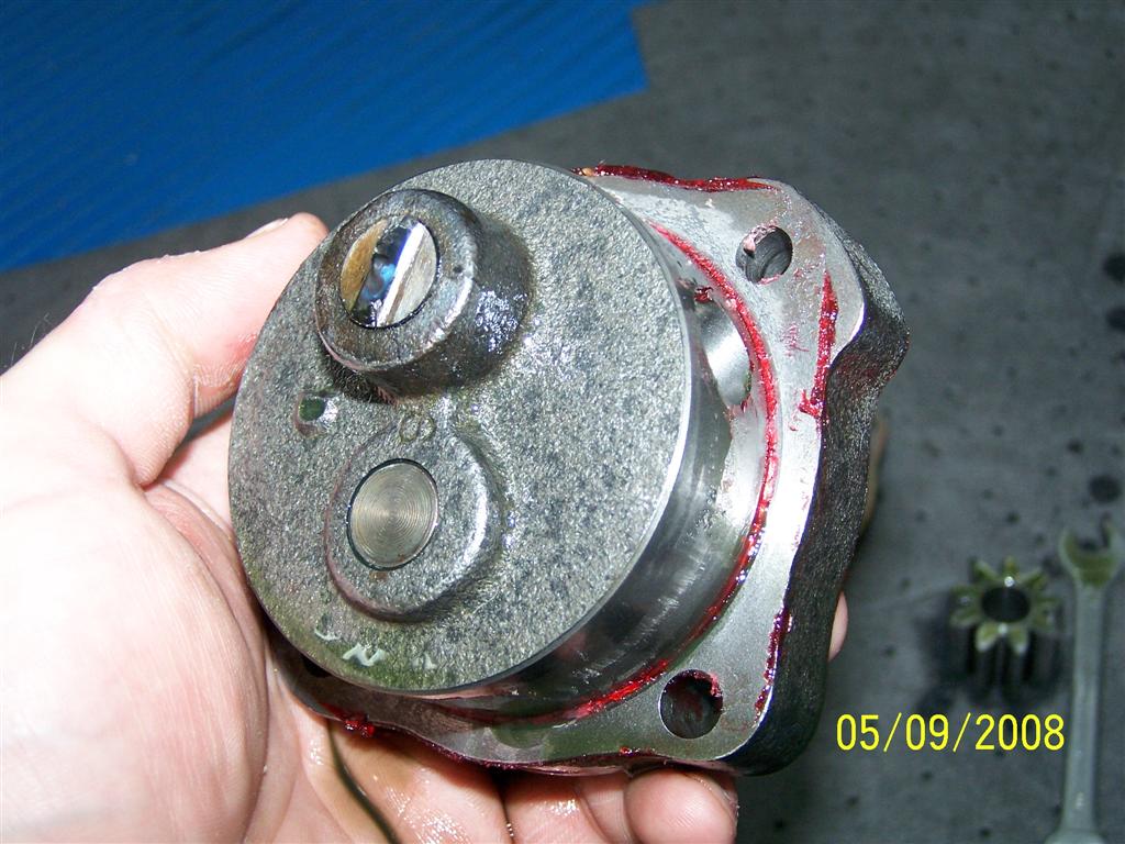

Jake Raby
post Nov 23 2009, 09:33 AM
Engine Surgeon
Posts: 9,398
From: Lost
Member No.: 1,095
Here is your modern day Melling pump.
This one failed a short time ago upon start up in a test engine on the dyno. I was quick on the switch and the engine wasn't compromised, but I was very lucky.
The oil pump drive isn't centered in the body of the pump with this unit so it snapped off the drive tang. Thats a fault I had never seen or heard of prior to this, now I inspect every pump for it no matter who made it.
Components are constantly changing. What worked 35 years ago or just last month doesn't mean a damn thing. We see this more and more with the AFU Economy as companies are cutting corners to stay alive and sending out JUNK in some instances.
Nothing ever stays the same- become set in your ways and you will get bitten in the ass. Constant awareness is key.

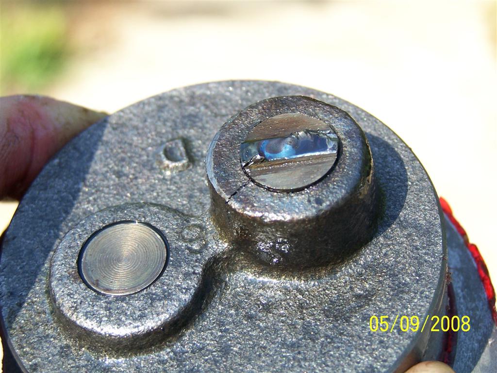

Jake Raby
post Nov 24 2009, 09:16 AM
Engine Surgeon
Posts: 9,398
From: Lost
Member No.: 1,095
Here is another...
ME733
post Nov 24 2009, 10:46 AM
Posts: 842
Joined: 25-June 08
From: Atlanta Ga.
Member No.: 9,209
(IMG:style_emoticons/default/popcorn[1].gif) ....Very Intresting...I wonder what caused the drive tang , where It broke off, to TURN BLUE......on both of them. Seems like with the offset that bad , the oil pump drive tang simply would not align with the camshafts internal indent, and insert into the cam, and may have been driven by the camgear bolts, which were hammering on the drive tang, causing the heat indicator (blueing) and ultimate breakage, (snapped it off). I wonder if that pump was actually for a 914 or something else. Any identifible part number?. This should be a good example of the fact that all parts should be checked before using them., especially If the oil pump drive and "idler" gears are not centered / centerlined, with the camshaft/ center of crankcase, and centerlined in the pump housing you have a defectively manufactured pump or one for some other application. Thanks Jake for the photographs and information. (IMG:style_emoticons/default/popcorn[1].gif)
