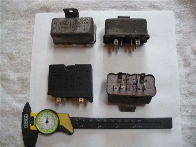

no PET diagram reference found; dual relay for L-jet FI system
cross reference number Bosch 0.332.514.129
check also VW bus part 071.906.059
2 styles found; one with metal case and one larger plastic case

071 906 059 A appears to be the part number from the PET for a 914 1.8.
Illustration 901-05, although the relay is not pictured.
My giant Bosch reference lists 0.332.514.120 as the 914 1.8 'combi-relay'.

I took these numbers off the parts so I'm not sure about the applications.
