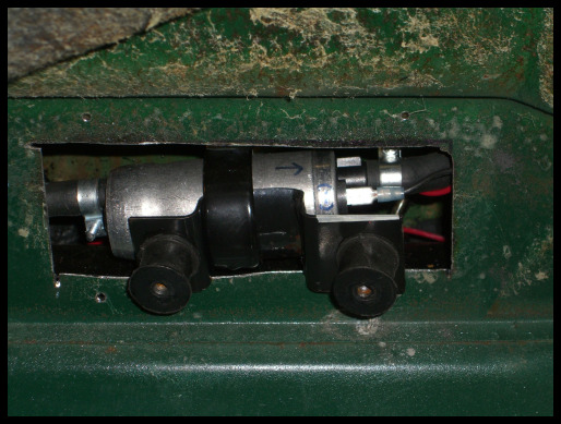

Thought I'd throw up six shots (in three posts) of where, and how, I installed the fuel access panel form a late model (75/76) into the firewall between the front trunk and the fuel tank recess, in my 1970 914.

tod914   Very nice and professionally done Ken. Think you...   Nov 28 2009, 07:44 PM
Vacca Rabite   Awesome. make sure you round off the metal you ju...   Nov 28 2009, 08:15 PM
kenshapiro2002   Used a file on the edges right away. May even glue...   Nov 28 2009, 08:47 PM
tod914   Ken how about JB welding on some nuts on the back ...   Nov 28 2009, 09:13 PM
kenshapiro2002   Sounds good to me. You like JB better than epoxy? ...   Nov 28 2009, 10:13 PM
Vacca Rabite   Why? Sheet metal screws work like a champ in this...   Nov 28 2009, 10:20 PM
kenshapiro2002   Zach...I'd trust you 100% if it weren't fo...   Nov 28 2009, 10:25 PM
Drums66   Zach...I'd trust you 100% if it weren't f...   Nov 29 2009, 01:19 PM
MrKona   Consider Rivet nuts. You've already got the ho...   Nov 28 2009, 10:32 PM
jmill   I'd go with a nut clip. Cheap and easy withou...   Nov 28 2009, 10:33 PM
kenshapiro2002   Yeah...maybe... I'd go with a nut clip. Chea...   Nov 29 2009, 06:09 AM
John Jentz   The factory used sheet metal screws. Why get fanc...   Nov 29 2009, 01:07 PM
9146986   A couple things that have helped me with sheet met...   Nov 30 2009, 12:00 PM

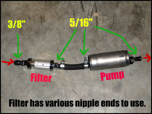

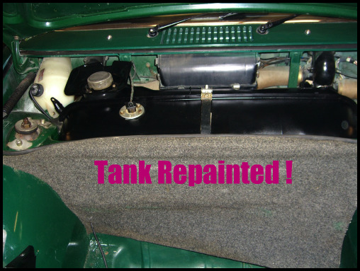

kenshapiro2002   Ok...I coated the bottom of the whole fuel tank we...   Dec 4 2009, 09:42 AM

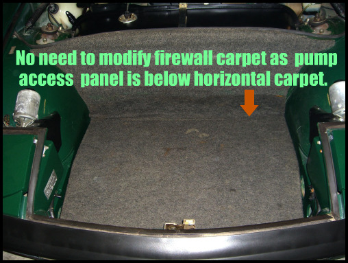

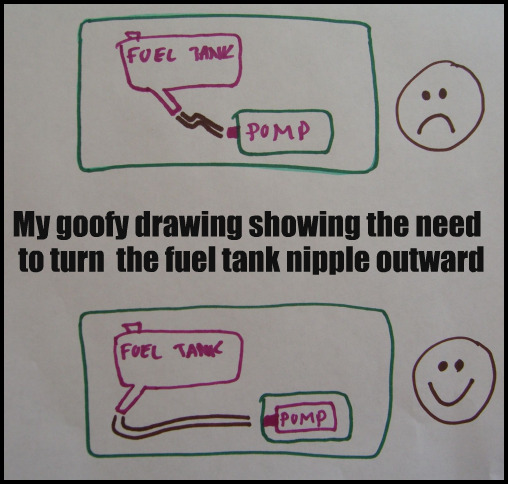

kenshapiro2002   RE: Late Model Access Panel For Fuel Pump Installed   Dec 11 2009, 12:12 PM
kenshapiro2002   RE: Late Model Access Panel For Fuel Pump Installed   Dec 11 2009, 12:13 PM
kenshapiro2002   RE: Late Model Access Panel For Fuel Pump Installed   Dec 11 2009, 12:14 PM
tat2dphreak   thread -serts just to give one more option you don...   Dec 11 2009, 01:57 PM
kenshapiro2002   Lotsa good ideas...keep 'em coming for the nex...   Dec 11 2009, 02:16 PM
