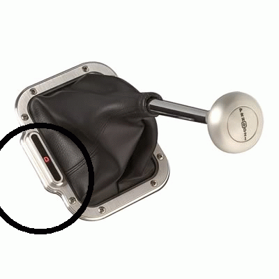

computers4kids   I found the shifter that was used in this conversi...   Dec 8 2009, 11:49 PM

computers4kids   After not being able to find a suitable shifter re...   Dec 25 2009, 12:04 AM
kg6dxn   Looks much better. I like it!   Dec 25 2009, 12:22 AM
JRust   Very nicely done Mark. That looks much better. Sti...   Dec 25 2009, 01:30 PM
computers4kids   Very nicely done Mark. That looks much better. St...   Dec 25 2009, 02:42 PM
Rand   hesitate losing the gear selector--it's part ...   Dec 25 2009, 09:52 PM
