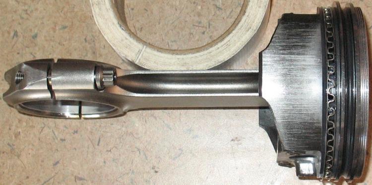

(IMG:style_emoticons/default/popcorn[1].gif) Thats a forged piston...It failed because the three piece (SET)OIL CONTROL RAILS were not installed. the centerpart/ as it was not restrained, expanded to the cylinderwall and ate itself and the cylinderwall,s up. the mammoth galling of the piston could also be from improper piston to cylinder wall clearances. a quick death in two directions. .............A FLAT cam, means that, in the begginning, there was no taper ground into the lobe....WHAT!!!!.....thats right GUYS camshaft lobes have a .5 to 1 degree angle GROUND INTO the lobe. This induces the LIFTER to spin/rotate with every cam lobe cycle.,( creating even wear for all the moving parts in the valvetrain.).................A" flat cam " is not going to destroy the piston, especially to the extent shown.... (IMG:style_emoticons/default/popcorn[1].gif) I do agree that buying a camshaft on e-bay is just N U T S !
You sure know a lot about a complete motor from one picture. Too bad most of it is WRONG. I'm not even going to waste time rebutting you, since odds are you won't believe me anyway since you apparently already think you know everything. (IMG:style_emoticons/default/mad.gif)

(IMG:style_emoticons/default/popcorn[1].gif) ...so YOU...must have built this engine...any Idea how the "flat cam" occured?, who were the manufacturer,s... It sure spit out some metal into the crankcase, and into the cylinders. (IMG:style_emoticons/default/popcorn[1].gif)

The missing oil control rings were removed before the picture was taken. (IMG:style_emoticons/default/rolleyes.gif) (IMG:style_emoticons/default/rolleyes.gif) (IMG:style_emoticons/default/rolleyes.gif) (IMG:style_emoticons/default/rolleyes.gif) (IMG:style_emoticons/default/rolleyes.gif)

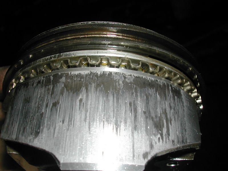

Since when is a wrong answer here a felony...particularly when the evidence is misleading. If I had a buck for every shakey answer here, I could retire.
BTW, at best those Deves style oil rings are shit.
Here's another pic of them POSs.
