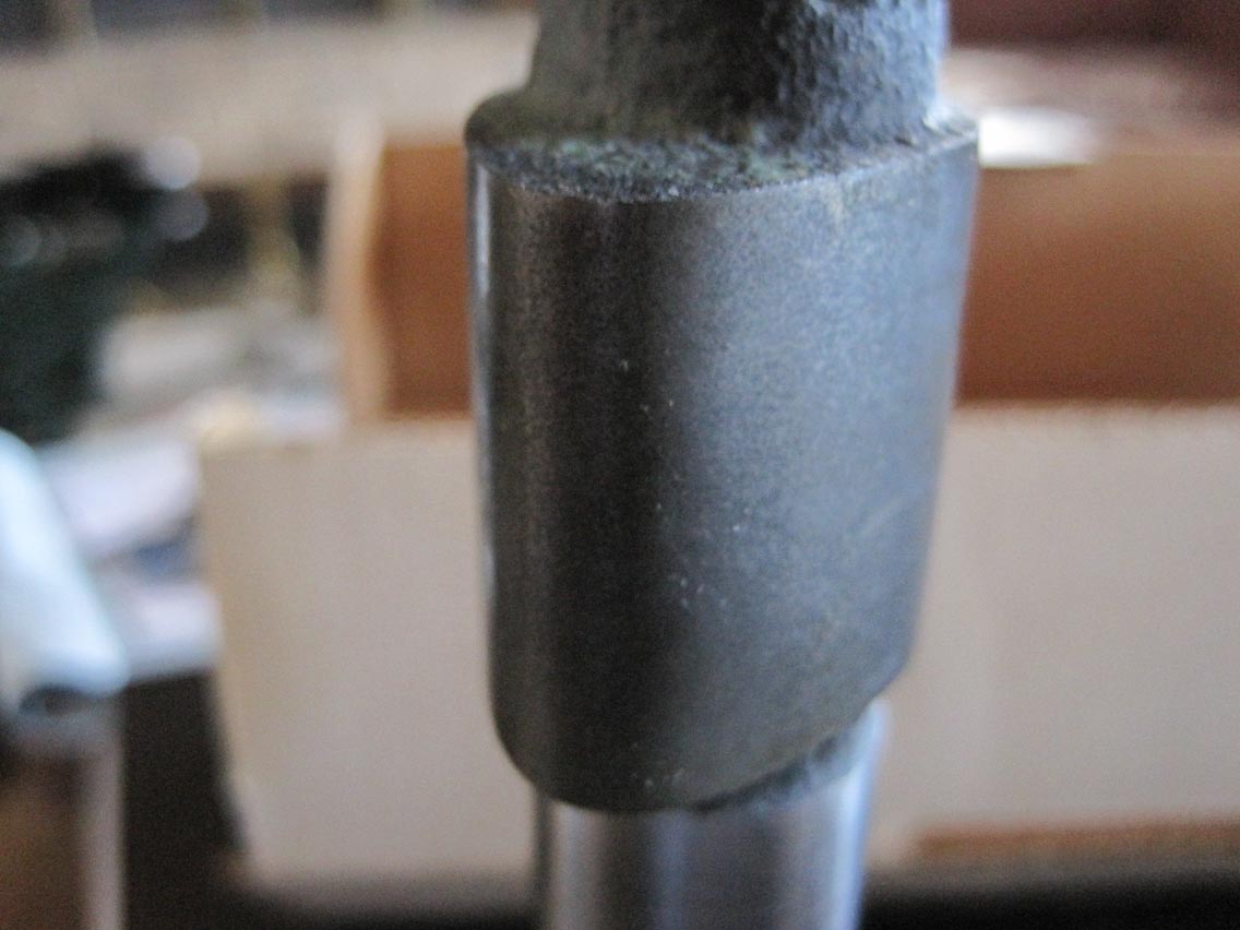

that cam was big. like 86a+ big. check out the big radius of duration. I used to use yamabond or tribond 1104 to seal a case. since jake's recomendations on sealants its alot easier to split a case for a cam swap.
where did it say hydraulic cam?

why did a flat cam eat that piston?

QUOTE(sean_v8_914 @ Dec 15 2009, 06:48 AM) *
Not being and ex-spurt, I would say the piston was installed with to little clearance or the engine was severely overheated.
Of course I am ignoring the plausibility of mounds of metal circulating with the oil.
But then, I am just a big dummy.

Serious amounts of metal in the oil = scuffed piston.

that 1/4" short lifter is insane looking. Ive seen some nasty ones but never THAT NASTY. that belongs on teh wall of shame.
Flat Cam Syndrome: the flat plague ended up being EPA enduced right? I think it was right about the same time when they removed teh ZDDP from teh oil...2006-ish?
