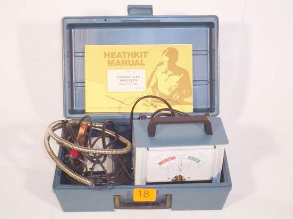

This is what I have. It's older than dirt but works great. I throw in a set of jets and go for a spin with the unit all hooked up. Find a big long hill put it in a higher gear and stomp on it. Check where your at, rich or lean. Poor mans dyno tuning.

That's great , exactly how do you hook it up ?? I have a staionary ( big ) exhaust gas analyzer , haven't messed with it yet , that sticks up the tailpipe ( proctoligist style ) . I'm interested , your's appears to be an older unit , please tell me more.

This one does the same thing. You slide the probe up the tail pipe and then hook it up to the 12v battery. There is enough wire to have the unit on the passenger seat. I duct tape the wires to the body of the car in spots so they don't get hung up and ripped out.

My old heathkit is a narrow band and it does react slower than the newer wide band units. It's analog and you can't split hairs with it like a digital unit. It does have a few things going for it. It's cheap, no need to weld an O2 bung in the exhaust and it's portable. It's payed for itself about 20 x's over.
